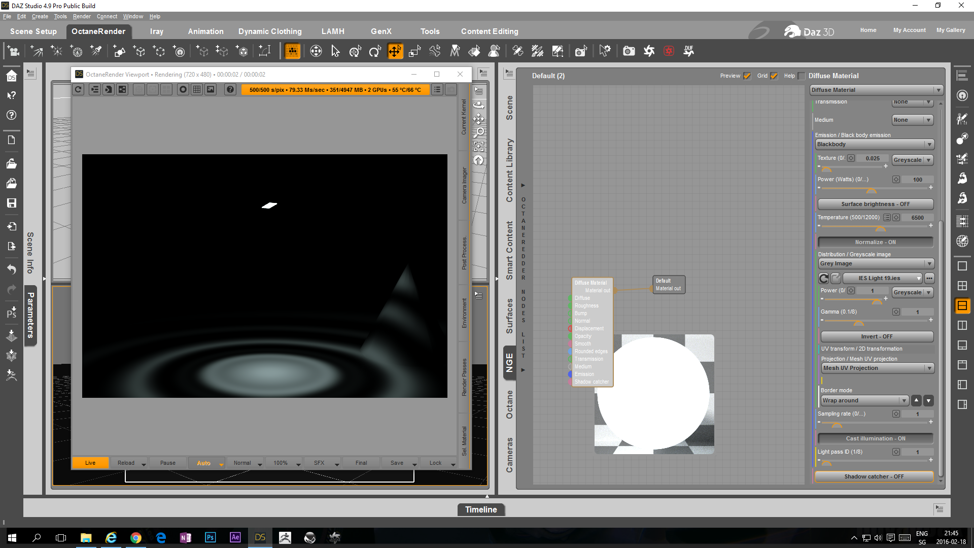

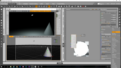

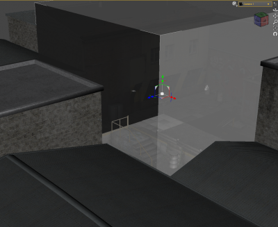

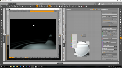

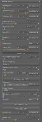

Revisited. Should I not be able to "see" the light rays? I only see the surface the light is striking. ???
Gateway i5 3.2ghz, 16g RAM, GTX 690 4GB VRAM, Windows 10 64bit, Poser Pro 11, DAZ Studio Pro 4.9, Daz Octane Plugin V2, Poser Octane Plugin V2

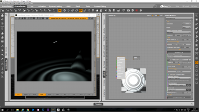

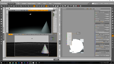

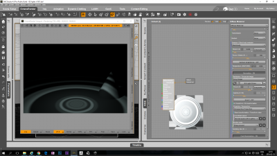

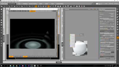

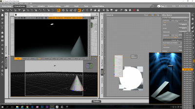

swipswap
Posts: 33
Joined: Thu Feb 12, 2015 12:35 am
the light needs to be scattered by a medium. if you shine the light through a specular material and attach a medium node, you should be able to achieve rays
in the pictures below i use a primitive cube to serve as fog to scatter the light
