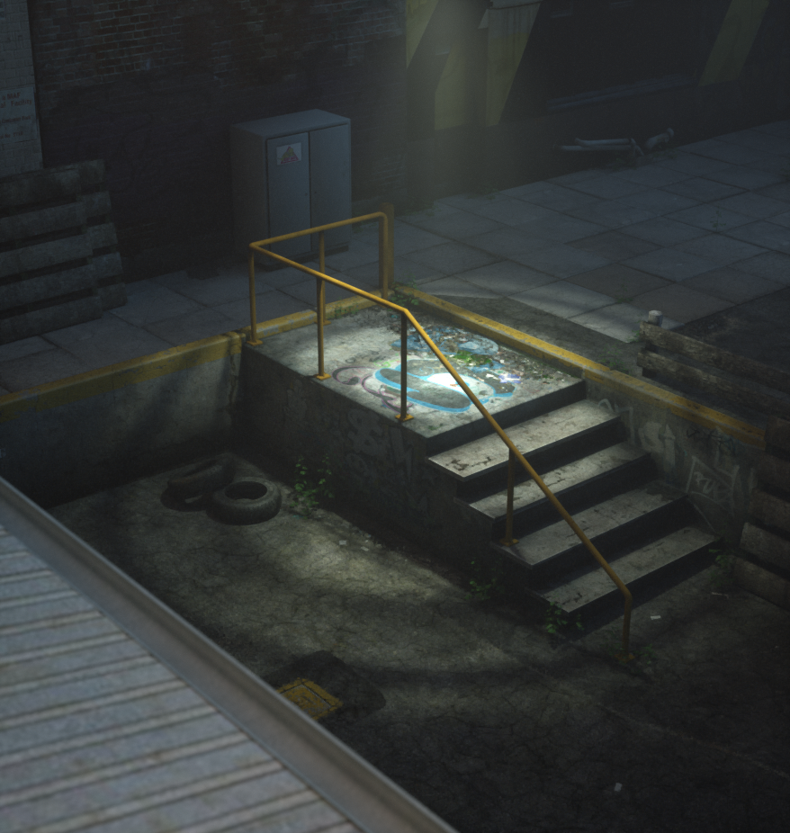

Revisited. Should I not be able to "see" the light rays? I only see the surface the light is striking. ???
