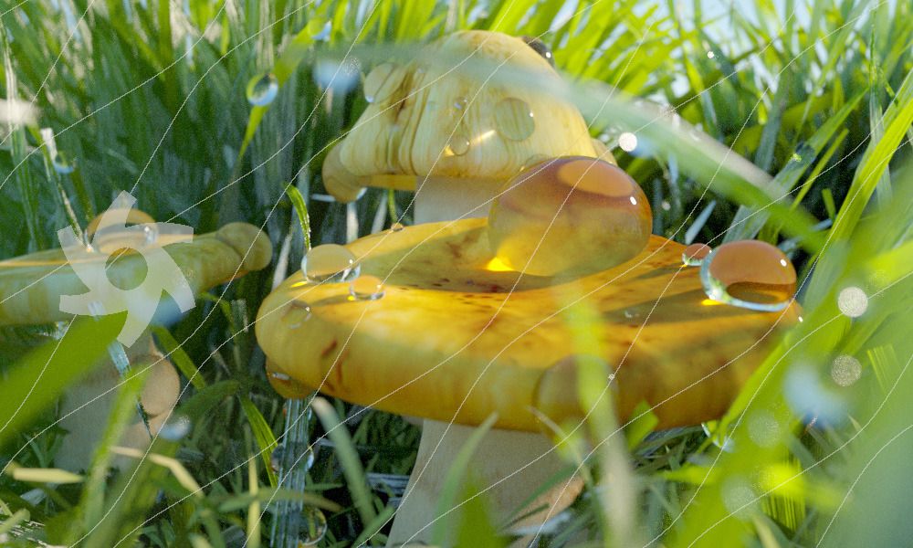

Now onto my next question Once I have deleted all my PFX strokes and can finally render the scene with a default diffuse shader added to the geometry, I went ahead and took a bunch of grass geometry and a few other things like mushrooms and dew drops and zoomed in and started tinkering with my grass shader, I created a specular shader with a sss node and some displacement and roughness and got a really nice looking grass blade with some beautiful lighting and created this:
Now I took this grass shader and applied it to all the grass in the scene and I tried to render and bam, it gave me some crazy UV error :?: :lol: It actually had the cheek to complain to me about a blade of grass that was created by converting a PFX stroke to Geometry :lol: :lol: :lol: :lol: I found this to be quite hilarious as I'm sure you could imagine ("what has a UV got to do with getting a render out lol it should just look messed up not fall on its arse and just refuse to render"), so I created a new render layer and started adding each patch of grass till I found the culprit and found that it was several of them, I checked the UV's and they were perfect as any paint effect grass stroke would be :roll: at this point I was pulling hair out as it was now late into Sunday night or rather Monday morning and I still wasn't able to render a blasted frame! :evil:
