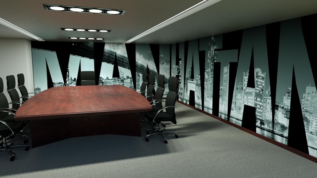

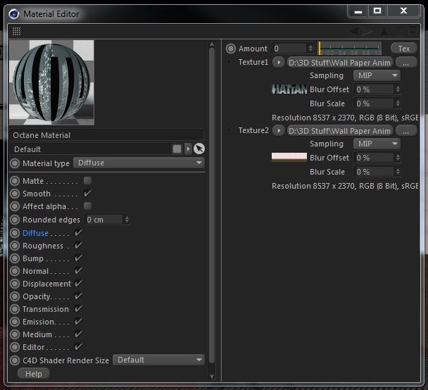

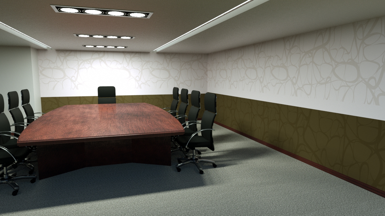

I have a room with "wall paper" on the walls, and I want to transition the walls from one paper to another over the course of 30 frames. I know I can create a mix texture and animate the "amount" slider to create a smooth dissolve. However, is there a way I can transition with shapes (like squares, circles, or a basic left-to-right wipe)? Here is a sample of what I'm hoping to be able to do: https://youtu.be/UWXl8dBn4uU?t=18s
Below are images of my scene:

Render your shape animation out as an image sequence and use it as a texture in the amount port of the mix material.
Posts: 10621
Hi frankjrmi,
the solution proposed by DinoMuhic is surely the best and flexible, an alternative could be to animate a c4d shader like gradient, spline, noise ecc. with he help of the auto baking shader function, but you could have some performance issues :roll:
