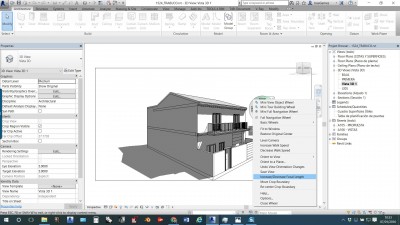

Hi Paul, to change the focal lenght you must right click in the complete steering wheel, and then you can modify with the mouse.

Thank you. Setting the Octane Focal Length from the Revit Focal Length is an excellent suggestion. However unfortunately the Revit API does not provide any means to get the Revit view Focal Length - so it does not appear to be possible to implement this.Hi Paul, to change the focal lenght you must right click in the view complete steering wheel, and then you can modify with the mouse.

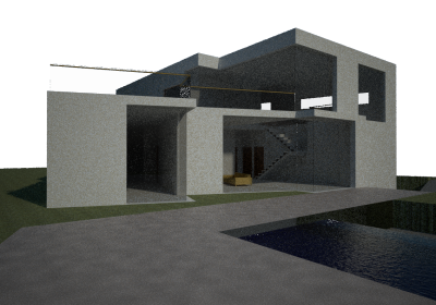

In the new V-ray plugin works... I dont know how they have implemented but it's working.
The same view with diferent focal lenght.
Many thanks! I'm sure you can implemented
Its very usefull

I have posted the question as to how to get the Focal Length on the Revit API forums. I will let you know if I get a response.In the new V-ray plugin works... I dont know how they have implemented but it's working.
