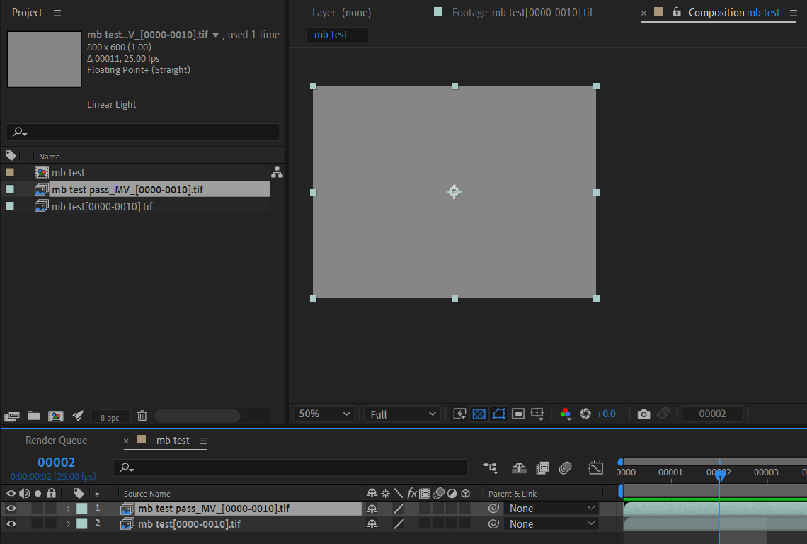

I can't seem to get a motion vector pass out of Octane (latest version)..it simply renders a grey solid

I'm actually seeing an all grey MV pass in 2.25, in C4D plug-in on Mac.

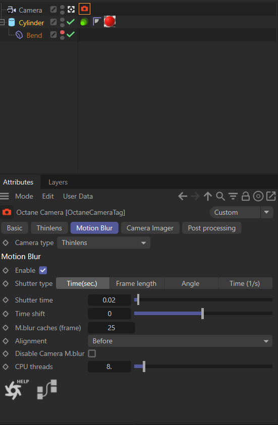

Your values are wrong in camera tag.
Set timeshift=0 and more shutter time as 0.02, 0.04, etc..

Aha, that totally makes sense. I overlooked that after pushing those around.
Thanks a lot!

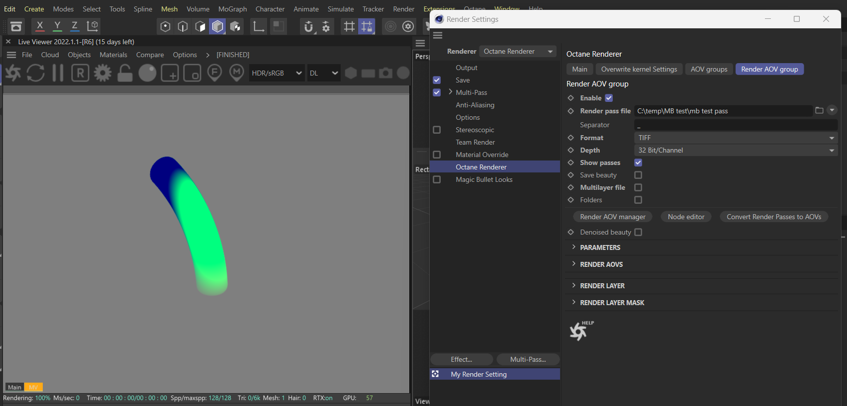

Motion vectors work just fine in Live Viewer, however when I render the sequence I get solid grey only
Cinema 4d 2023, Octane 2022.1.1_R6
Posts: 16068
Location: Türkiye
Don't know what's wrong on your scene but that's not working. But copy/paste it to a new scene and it works. Default settings are optimal on every case. See the scene.
