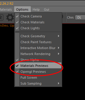

what is "Octane: generate material" and "Octane:Opengl Preview" in the statusbar ? can this be deativated?
i already tried deactivating use octane for opengl preview in settings. i also deactivated textures in viewport.
when i have a big scene with a lot of materials (200-300 materials) it takes a lot of time until all materials are generated and i cant really work in the scene at this time.
i can upload and send you a scene like this vie PM if you want oktar
Version 2.24.2-R2 (22.01.2016)
These are messages about to show material preview/opengl texture generation. You can disable this optionally in LV->Options.fuchsundvogel wrote:what is "Octane: generate material" and "Octane:Opengl Preview" in the statusbar ? can this be deativated?
