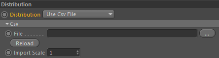

when i switch octane scatter object distribution to "Use Csv File" there is no linkfield for Surface.
Posts: 16068
Location: Türkiye
fuchsundvogel wrote:when i switch octane scatter object distribution to "Use Csv File" there is no linkfield for Surface.
We don't need any surface for this mode.
