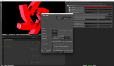

It seems the render animation script is broken in Octane 3... we would love to try some animation in Octane 3, could you fix it?
Kind regards
Filipe
Posts: 10639
Hi Filipe,
weird, here is working with no issue :roll:
do you have any error message?
ciao beppe

Hum... maybe I don't have that one, does it come with the build?
manalokos
Posts: 443
Joined: Fri Nov 18, 2011 4:43 pm
Oh! OK I understand, batch rendering now is able to render animations... cool
