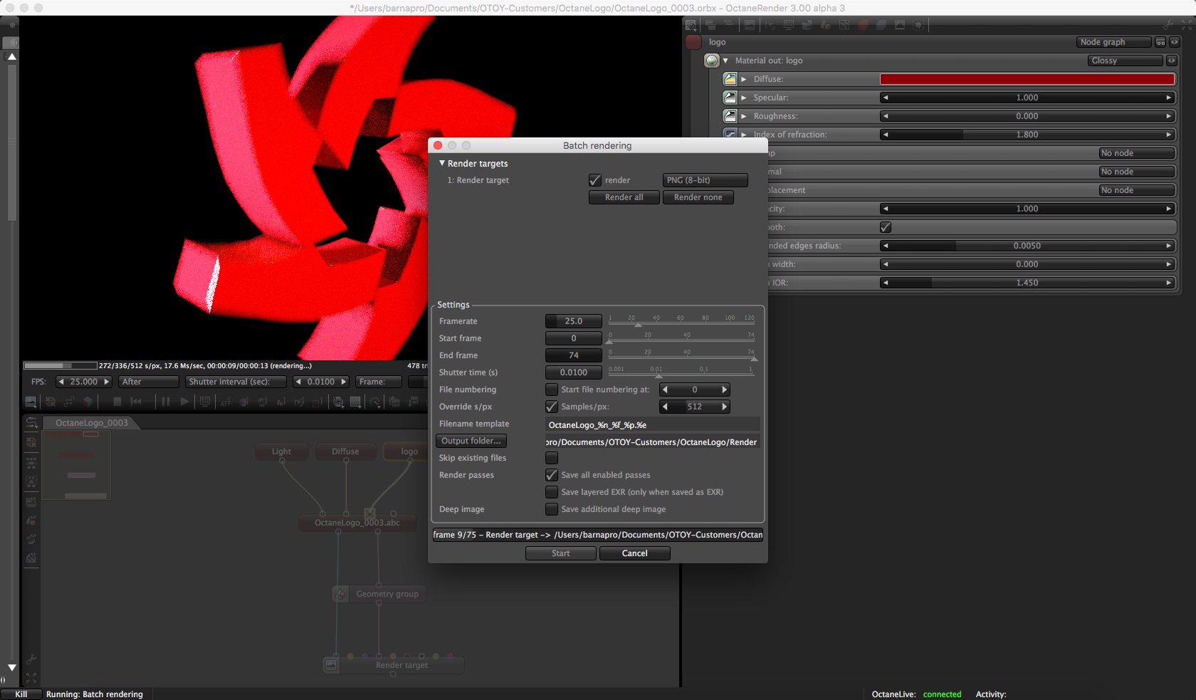

Hello
It seems the render animation script is broken in Octane 3... we would love to try some animation in Octane 3, could you fix it?

Hi Filipe,
weird, here is working with no issue
do you have any error message? ciao beppe

It is this one, it is partially broken, but I am currently only using the pos and target extraction, so I can control other parameters directly in Octane...
It works normally and with other animation rendering scripts, but not with this Batch rendering script.
