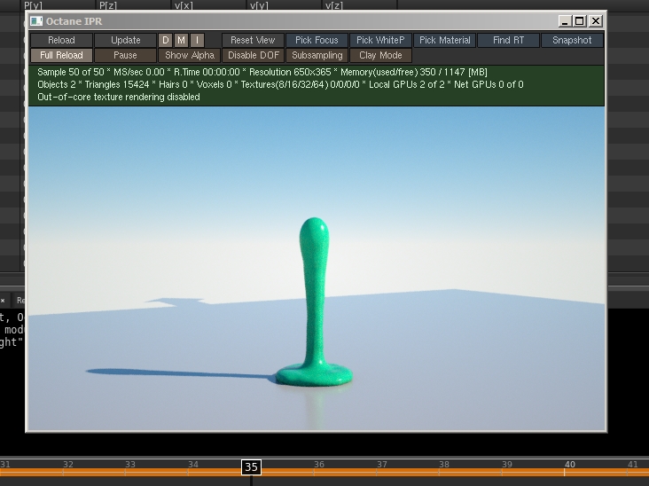

Was doing some DOPS stuff in Houdini and noticed the IPR wouldn't update with "FULL RELOAD" mode on (same for rendering) Just checking if this is meant to be the case or will it become something that updates like the regular transforms etc.

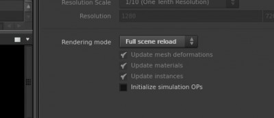

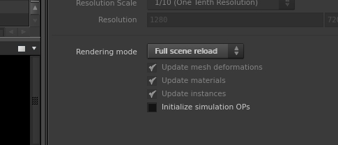

Yes, this kind of scenes must be rendered in "full scene reload" mode, or with the "Full Reload" option enabled in the IPR. The problem is that this DOP simulation builds an object without a constant topology among the frames (variable number of points and polygons), so the mesh can't be updated and the plugin must reload it.
So to render this scene you must enable the full scene reload in the ROP or in the IPR window.
