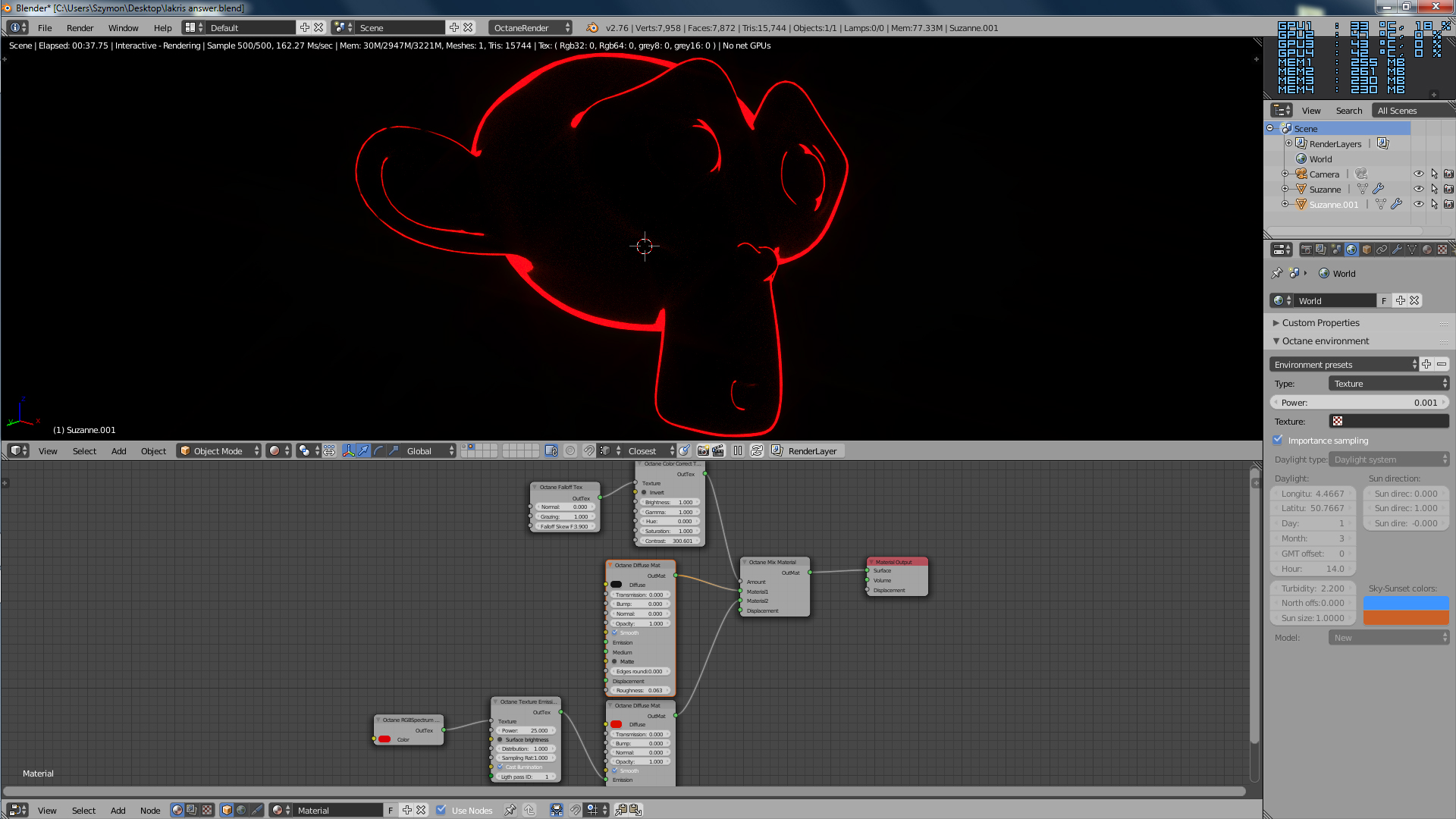

I need help with creating a shader or finding a way to create a lighting kind of effect
(yes, almost like my hologram questions)
What i want to achieve is, to have the edges of my models to light up(emission i guess), and the fill is just diffuse or glossy or even invisible.
In normal Blender i think there is a toon shader, where you can render only the edges(outline) but i dont know, if you can apply emmision to it
Gmunk' s picture shows it in his Asus ad:
Thx
Lakris

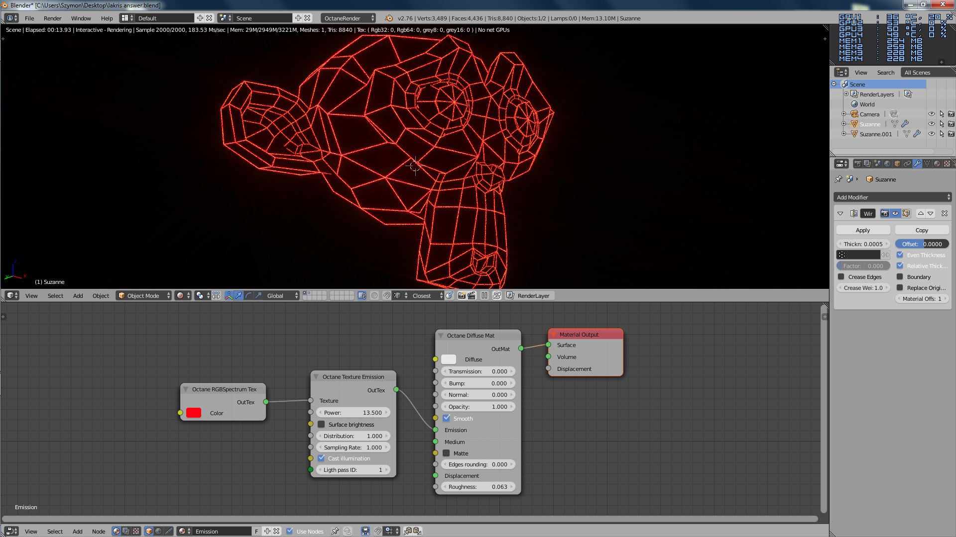

Hello lakris,
maybe the wireframe modifier or fallof texture could do the job?
Cheers,
Szymon

lakris
Posts: 79
Joined: Sun Aug 21, 2011 12:27 pm
Location: Copenhagen, Denmark
Yes, Thank you!
looks like a solution.
I will have to experiment with it, i only want the "outer" edges of an object, if it makes sense.(like the falloff but more edgy)
Maybe i will have to use the wireframe modifier, and then remove all i dont want inside manually...

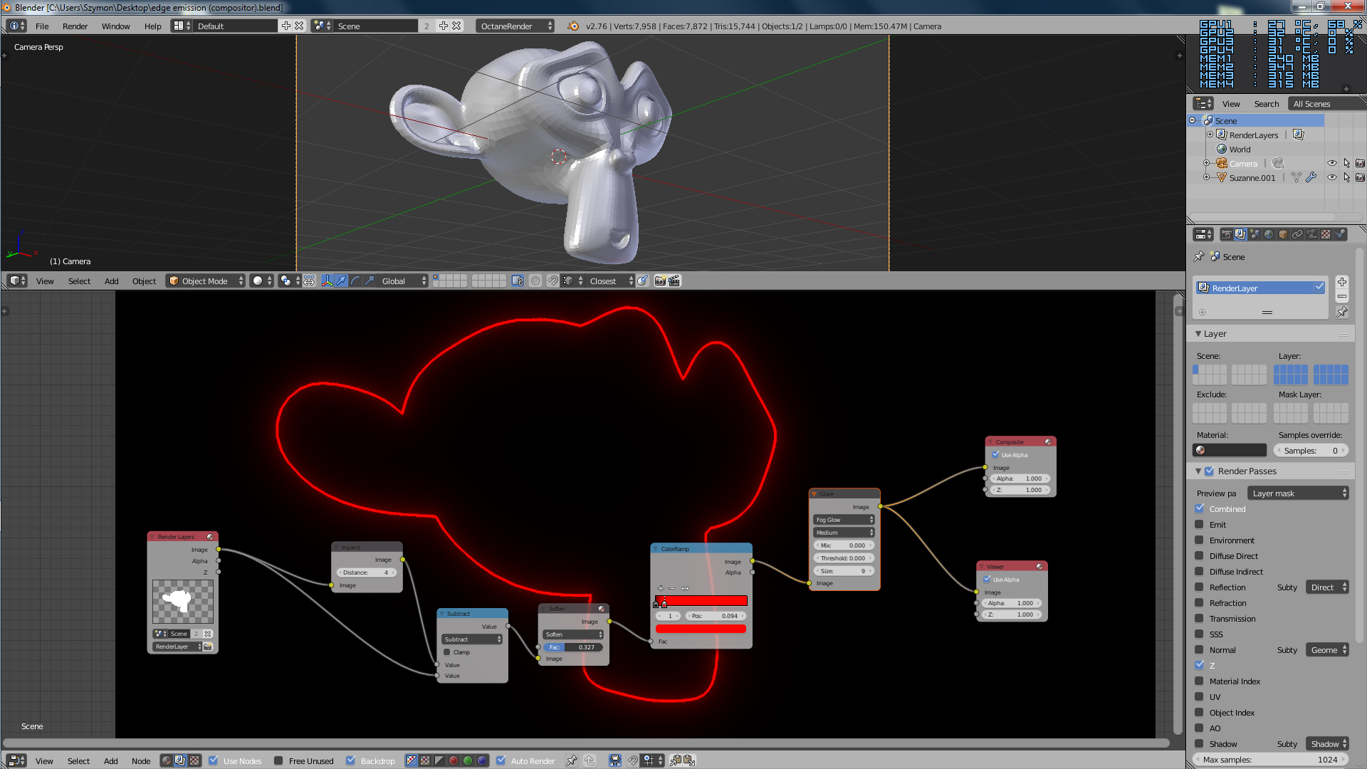

simdal wrote:hello, you can attach the file blender?
Sure thing:) Have a look at "edge emission.blend" attached below.
lakris wrote: i only want the "outer" edges of an object
Maybe try starting with something like this:
... and then composite this with your rendered image. I'm not sure what may be the best way to do this, but there must be some;)
Check out "edge emission (compositor).blend" and see if this could be of any use for you...
(568.86 KiB) Downloaded 250 times
edge emission.blend
(630.94 KiB) Downloaded 258 times
