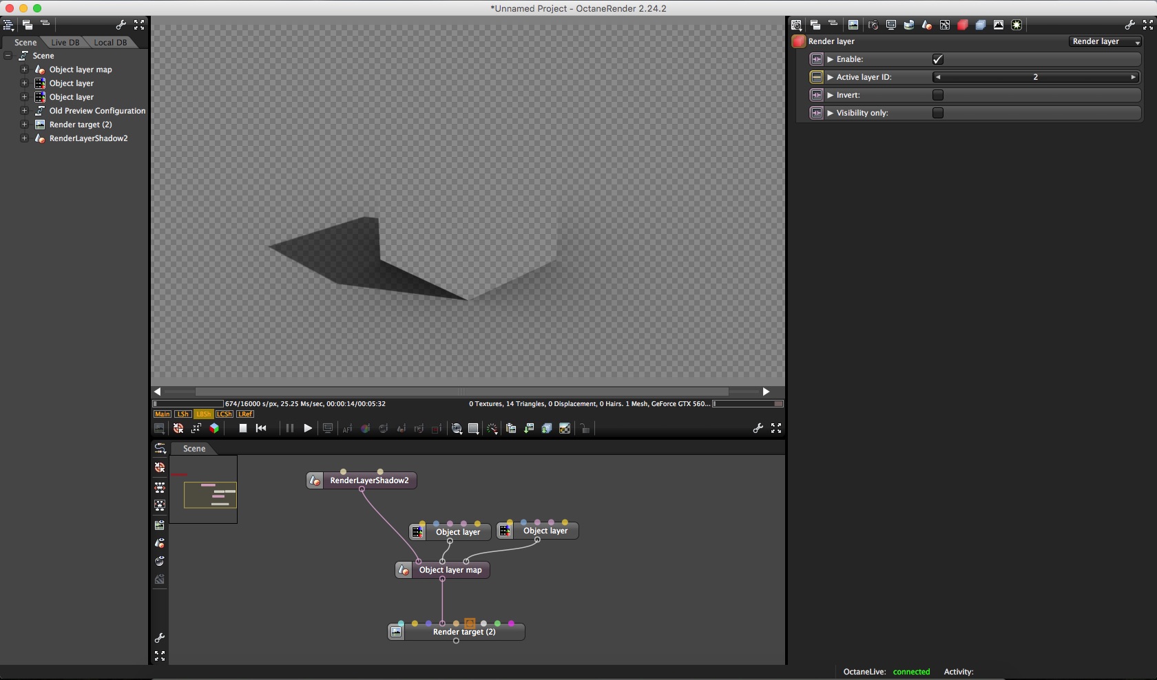

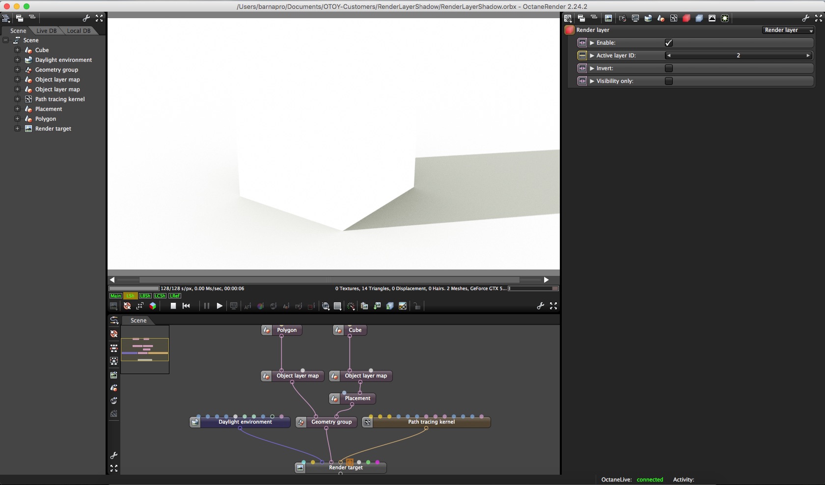

great, anyway here are a couple of examples, one with two separated objects and the second with one unique mesh, I hope that they could help other users to figure out better how it works ;)
separated objects
separated objects

single mesh
single mesh
