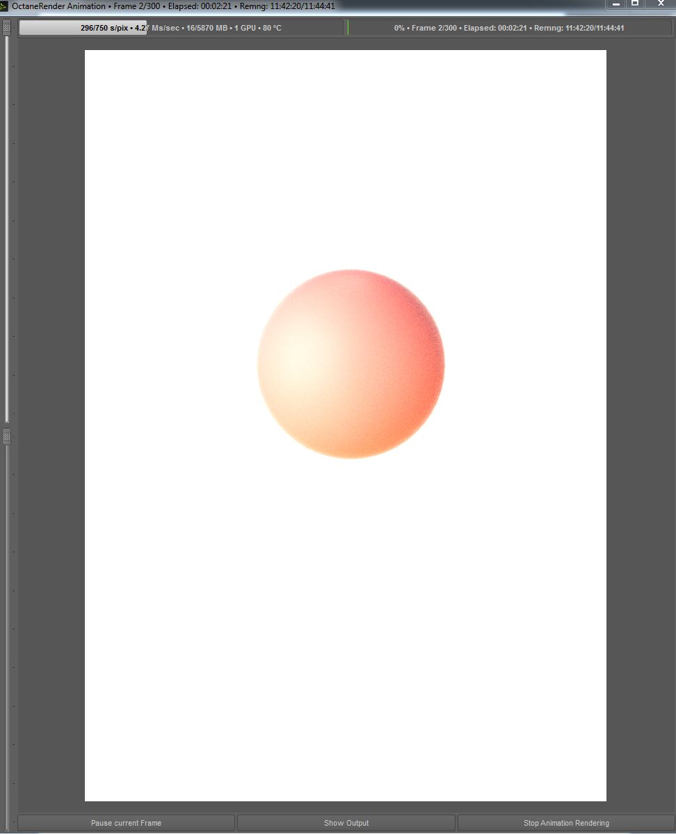

If this is still happening on the latest version, can you post some screenshots of the animation and your settings pls. A sample scene using a cube prop would be helpful too. My best guess is that animations are saving with tonemapping turned off. What filetype are you saving too? png or exr? If exr - there are Linear/Untonemapped options, which will save in a different color space to what you see in the Viewport.How come the animation exposure doesn't match the normal rendering exposure?
Paul
I tried with the new version in ds4.9 but still get the same result. I tried saving in all the available image formats, but still get the same result.
Here are the settings and i added a render of the still render and one of the animation render.
