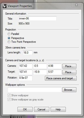

is there any chance this could also work in octane for Rhino?

V-cube, it just might, is there any way of entering camera data in Rhino?
well you can move the camera position and the camera target position to specific locations, you can specify the width and height off the viewport and you can enter a length lens for standard 35 mm camera which results in an according FOV
here is the dialogue :

Excellent, camera position & target are supplied already, and I'm calculating the camera roll internally... which means I can make this variable up for grabbing aswell. The camera lens length is something I will have the figure out. If I can get that, you're all set.

I think I got the variables correctly calculated for Rhino now ;)
Notice the function RENDERER under MAIN, you can pick your program of choice there and the export section of the GUI will adapt to it.
