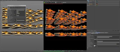

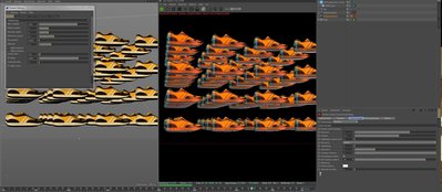

I always get an outline when alpha is enabled. Don't know if this a problem or i do something wrong. But in the old version 2.22.2 i got a clean picture without any outlines.
In 2.32.2R5 i can't get a clean picture without the outline. Did i miss something?
If you take a look to "Keep Environment", it keeps background color in (alpha=0) pixels. In LV mixing of pixels that's generating this outline if you have a bright background. That's very logical result. Can you see where is the problem? Also always test that mixing of output with background on a compositing software. It can calculate this edges better than LV output.Pixelkingdom wrote:I always get an outline when alpha is enabled. Don't know if this a problem or i do something wrong. But in the old version 2.22.2 i got a clean picture without any outlines.
