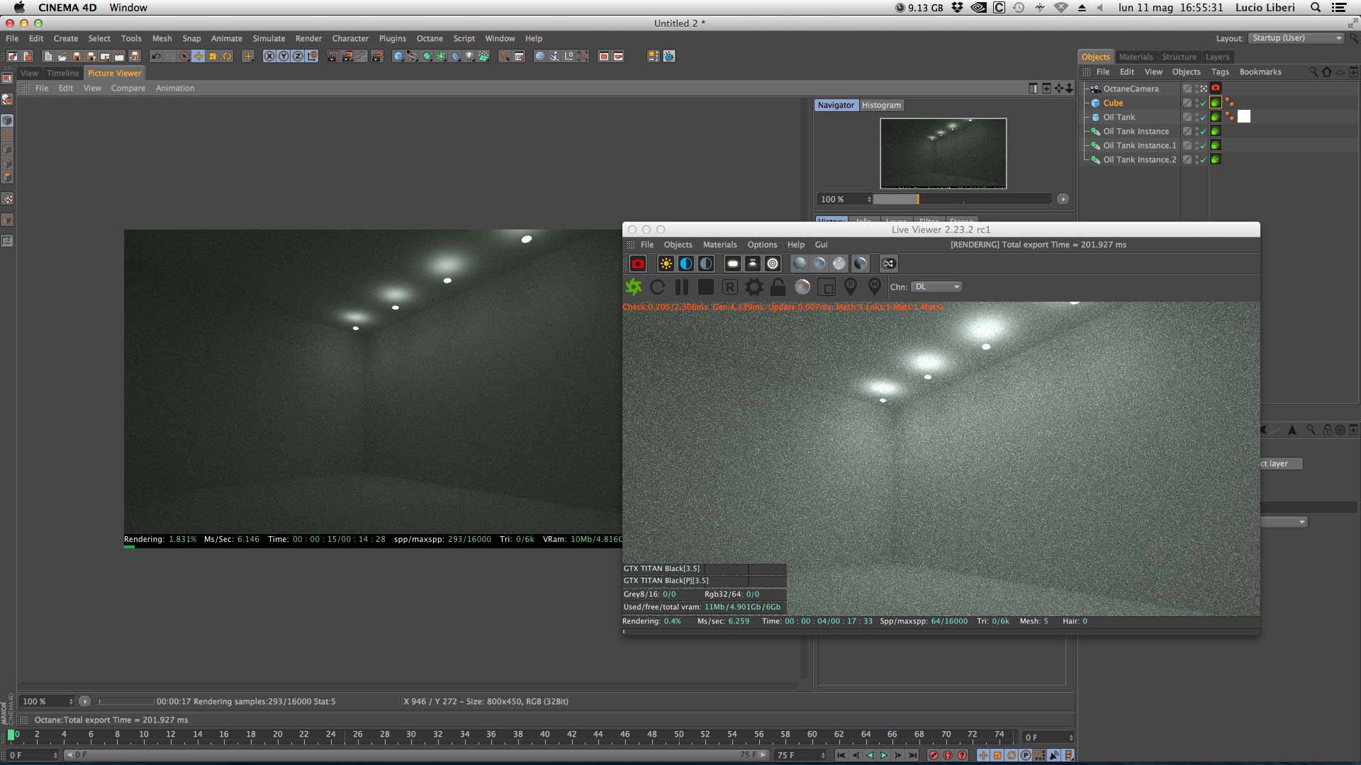

Hi Ahmet!
Thank you for your GREAT job!
But, now, I've a big problem: the rendering doesn't match the live view rendering, as you can see...
I've just update to the newest release 2.23.2_RC1 and the problem is persisting.
At the moment I'm still working around the model, but, in a couple of days, I have to run the final rendering.
The spot are mapped as emitter and it doesn't matter if they are instances or real model...
So, please, tell me something about.
Thank you
L.
Mac Pro 5.1 -16 GB- 2 x Titan Black 6GB - Titan Z - MacOS Yosemite 10.10.4

lucioing wrote:
Hi Ahmet!
Thank you
L.
thanks! What do you mean? Amout of illumination from lamb geometry?
lucioing
Posts: 229
Joined: Wed Feb 19, 2014 4:01 pm
Location: Rome - Italy
The spot seems to be blind... they doesn't emit light...
L.
Posts: 16067
Location: Türkiye
lucioing wrote:The spot seems to be blind... they doesn't emit light...
L.
If you don't use a objecttag for rendering, it will be collected as single mesh. That's the reason. Please see latest tutorials and FAQ.
lucioing
Posts: 229
Thank you, but, it seems it doesn't change...
L.
