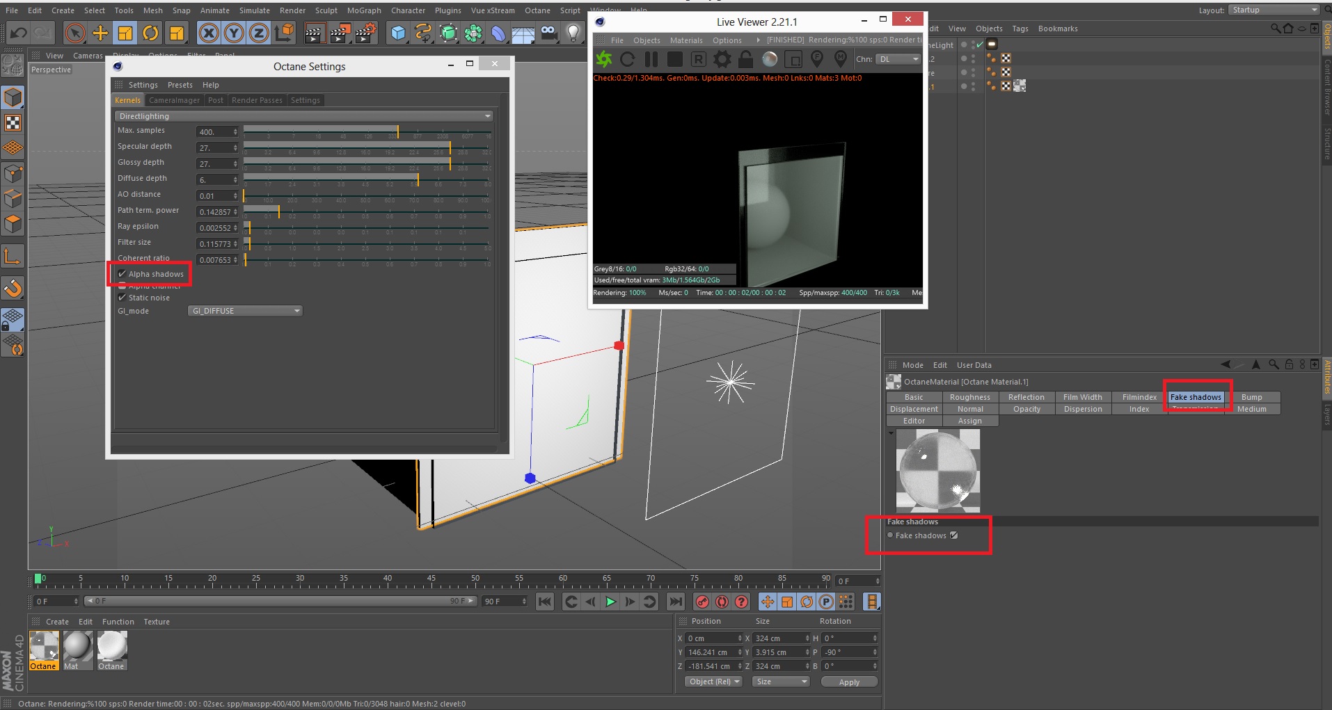

See attached image.
Turn on alpha shadows and use the fake shadows option in the material settings.

thx very much fooze!
i must have missed the double box to check in fake shadows inside material tab.
thx!!!
