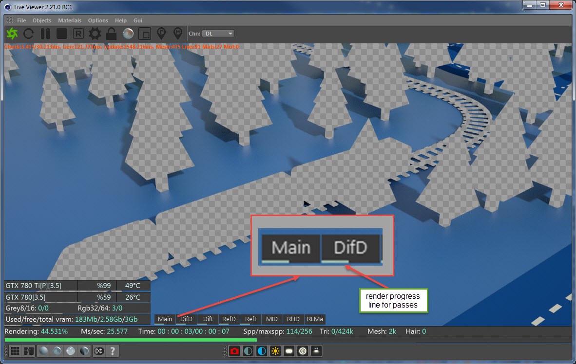

Do you think that all passes can be calculated together?
Beauty and light passes is done same time with main pass. Each info pass is calculated in different calculation phase. See pass buttons. They have a small progress bar to show how is going the process. Try to lower maxsamples for less render times.
"Out of core" is in settings->out-of-core section.

Hi mike,
First these parts is written by Thomas(Strafied). I mean the passes in renderer. I can't say what's the plans about optimisations. But people always cry when a feature comes out. Improvements and also optimisations takes big time. People should be more patient and try to optimise their render times. Also some people cannot understand the challenges of GPU rendering. There is lot of limitations and bottlenecks. Guys from Otoy are always trying to improve the things.
Also i write that how works the passes. Follow the progress bar in buttons and tweak maxsamples for better times as in image.

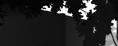

Sorry, taht i run after you with this question. im running 2.16.2 an ive got a problem.
Im using Rednerpasses and I am wondering if I am doing a mistake with my Z-depth-pass. If you look at the image below you see, that the leaves of the trees don't show the alpha. The depth shows the pure geometry. Is this an expected behaviour or am i missing something?
Posts: 16068
Location: Türkiye
momade wrote:Hey Aoktar.
i can't remember how works on 2.16. It's giving alpha on 2.21
