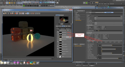

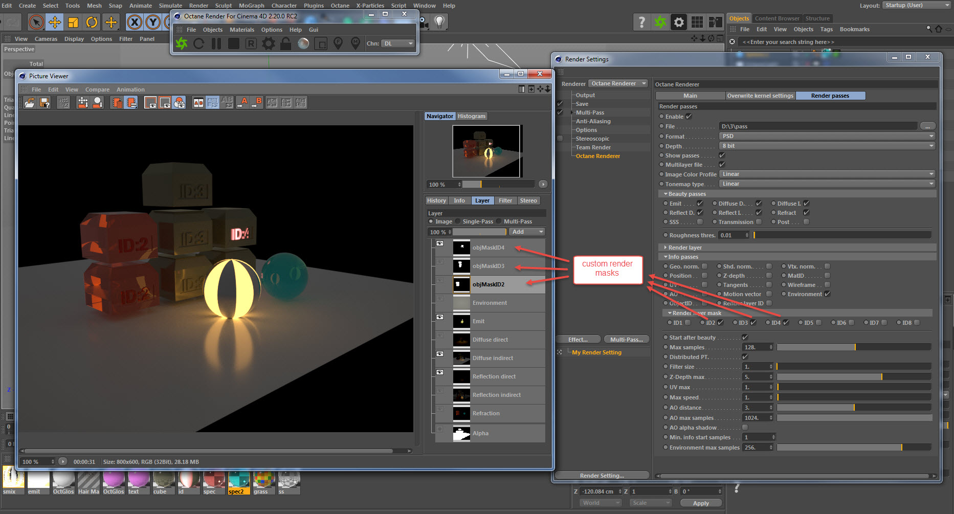

- New render layer functionality for render passes. See Render layer section in Settings/Render Settings.
- Multiple object mask output for several layer ID's. See
- Affect alpha option for specular materials
- Improved sliders, real number controls with high precision
- how to get render layer for some objects?
put a octane object tag to desired objects. activate object ID and set layer ID as 2. go to render layer section then activate and select layer id as 2. select some shadow or reflection passes from same section. you'll see some on screen buttons on live viewer to switch between.
also you may need to activate alpha channel on kernels. also may need to set on show alpha command from LV's menus.
colored shadow will works with specular material's fake shadows.
-to get object masks for multiple layerS, check render settings -> render layer masks. no needs to activate render layer for this functionality. plugin will do all operations for that.

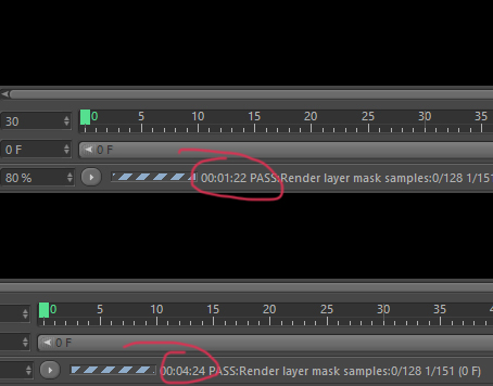

I have a problem in new version 2.21.1, that wasn't before in 2.20.0 RC2 in the same scene.
In sequence rendering, after render beauty frame and beauty passes, octane starts to render other passes, including layer mask. And octane can render layer mask forever, without any progress, untill i stop it manually.
| i7 3930k | 32GB | gtx 1080 ti | WIN 8.1 64
Posts: 16068
Location: Türkiye
Kemanjo wrote:Hello, Aoktar.
thanks. I see same problem here especially with info passes, i'm trying to fix it.
