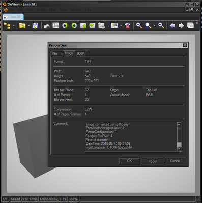

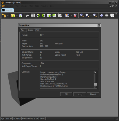

Octane plugin definitely fills the IPR window buffer with 32-bit image data when rendered with HDR formats set in preferences.
What Maya saves from the IPR window - is not controlled by the plugin, it's internal Maya's processing. I get the same looking properties of files saved from IPR window's "File/Save" menu after Octane IPR and after MentalRay rendering.
Octane:
MentalRay:

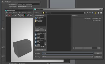

Here's the recipe for 32bit IPR (2.x Octane / Maya)
1 Maya > Render Settings > Common: Imageformat Tiff16
2 Color: Raw
3 Save from IPR window as OpenEXR (*Make sure your save options are set to save RAW)
This saves 32bit images from Maya IPR.
