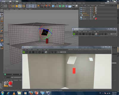

Also, i am a beginner in octane, so do u think u can tell me why the liveViewer render is always with white background and the floor object doesn't render in liveViewer or Pictureviewer with octane render? I am also attaching a screen-capture for that...
If I have only one light in the scene then, the rest of the background should be mostly black right? (I put an octane ies light inside an open-ended box as seen in the scene and reflection)
i changed the firewall settings to un-block octane... and it started showing liveDB from c4d.
thanks for ur kind help..
Floor is a solid object. So does not generates any polygon output. Also spheres with render perfect is same on picture viewer. We can use them because octane has not solid objects. I hope that's clear. Also plugin behaves little different for lighting. Always creates a environment lighting. You should create a sky with black texture as in attached scene.
