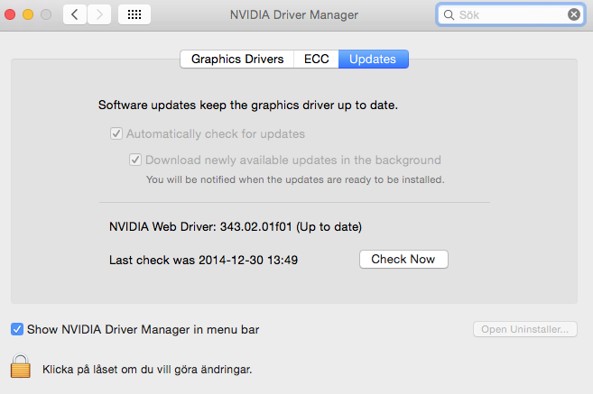

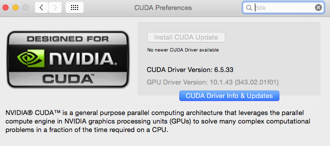

Updated Yosemite and Nvidia installed new web driver.
See attached.

It all looks correct and it should work. I can think of only two reasons why it doesn't work: Either there are still issues with the drivers or the kernels which were compiled on OSX are broken for Maxwell. Unfortunately we can't test the 980 on a Mac here. Could you check if other CUDA applications work on your system with the 980?

Please try installing CUDA 6.5.25
This is a working version.. The new 6.5.33 doesn't work.
Let me know if it doesn't work. I'll head home and find out what Nvidia driver I use then you can use the combo (Nvidia and CUDA) to get it to work. :)

Ok, known working setup:
GPU: 343.02.01f01
CUDA: 6.5.25
OS: Yosemite 10.10.1
