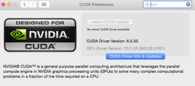

Updated Yosemite and Nvidia installed new web driver.
See attached.
GTX 980 and Yosemite

It all looks correct and it should work. I can think of only two reasons why it doesn't work: Either there are still issues with the drivers or the kernels which were compiled on OSX are broken for Maxwell. Unfortunately we can't test the 980 on a Mac here. Could you check if other CUDA applications work on your system with the 980?

Damn! I can't get it to work. Spent hours reading forums on nvidia drivers and versions and terminal hacks. No cuda apps are working for me. I'm giving up. Will keep running windows until yosemite and nvidia are friends.

Please try installing CUDA 6.5.25
This is a working version.. The new 6.5.33 doesn't work.
Let me know if it doesn't work. I'll head home and find out what Nvidia driver I use then you can use the combo (Nvidia and CUDA) to get it to work.

Ok, known working setup:
GPU: 343.02.01f01
CUDA: 6.5.25
OS: Yosemite 10.10.1
GPU: 343.02.01f01
CUDA: 6.5.25

Thanks for that info! Will try this. To downgrade CUDA - is it just to download apropriate installer and it will overwrite?kibbycabbit wrote:Ok, known working setup:
GPU: 343.02.01f01
CUDA: 6.5.25

Yep. Install will overwrite installed copy.

for mac there are different CUDA installers for maxwell 2 type (geforce 980 and 970) and all older cards, probably you did install the wrong one? this seems to be the latest one for 980 cards:
http://www.nvidia.com/object/macosx-cud ... river.html
see discussion and tips here:
http://www.xlr8yourmac.com/index.html#N ... DA_Updates
ordered a 980 card myself, so i will check this next week.
cheers
markus
