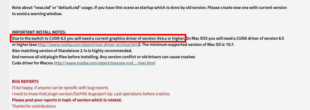

I cant render.. after restarting windows it says there is no cuda device. I also cant find and graphicscard settings in octane settings anymore. I have a gtx 780 6gb and worked with octane until today. :?
Posts: 16068
Location: Türkiye
Please see this release notification, marked as RED rectangle. thanks
kehrmaschine
Posts: 17
Joined: Sat Nov 01, 2014 8:40 pm
