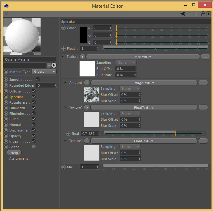

hi! i don't know if this is a problem related to this version, but i noticed this...
every time i set my material this way
the float texture nodes seems to be stuck together i can't move them indipendently. even if i cange one of them or both to rgb spectrum i have all kinds of problems... i change one value and the other becomes black with no reason. is this a bug or i am setting materials the wrong way?
(this setting is the same i saw from silverwing vfx obstacle scene http://www.silverwing-vfx.de/free_stuff.html)
yes, i'm aware of. This is a problem of custom sliders. I think that's the time of replacement the sliders with default sliders. At least will be a option to chooseturtles123 wrote:hi! i don't know if this is a problem related to this version, but i noticed this...
