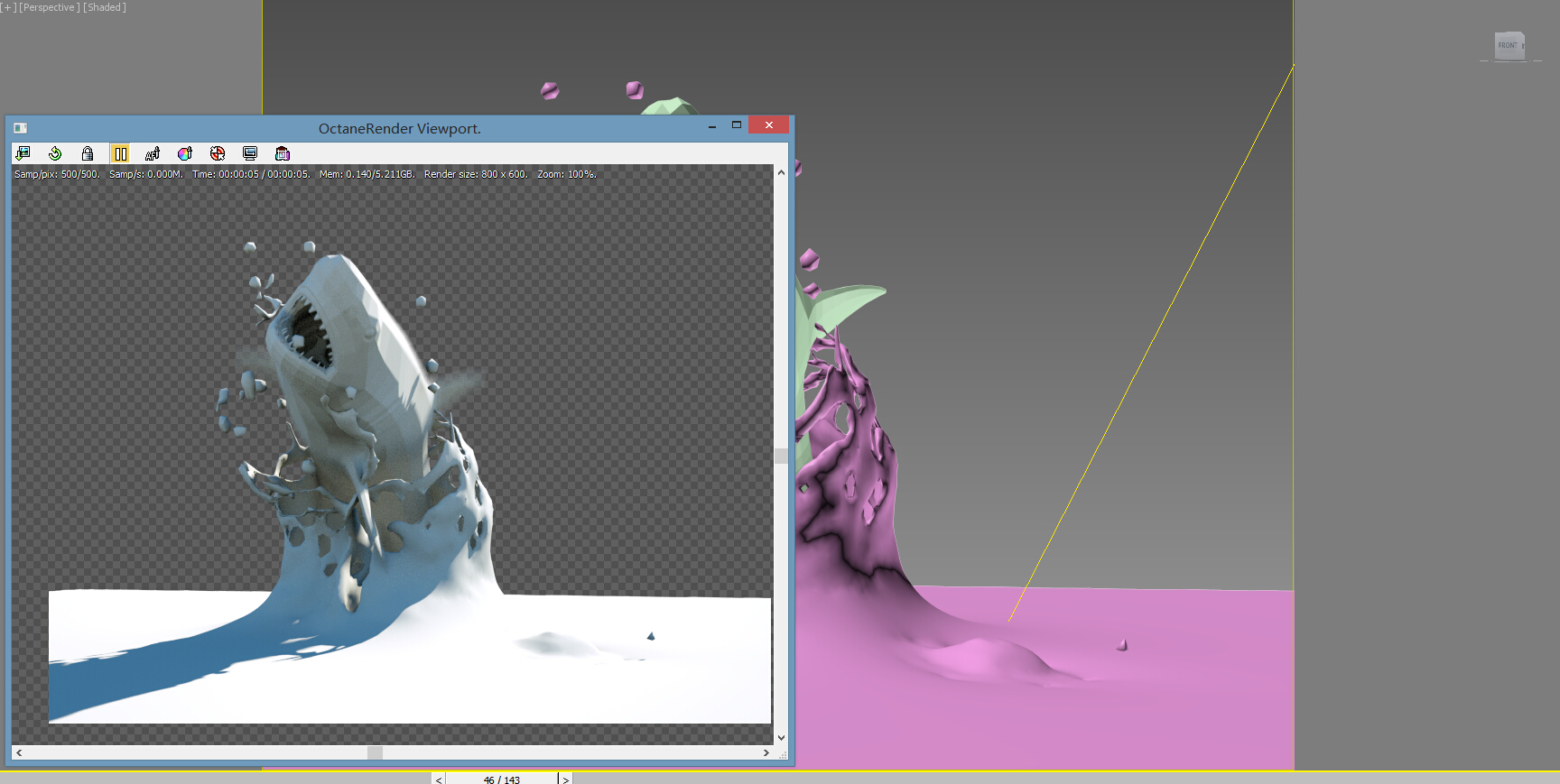

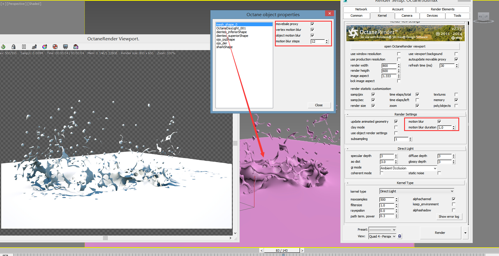

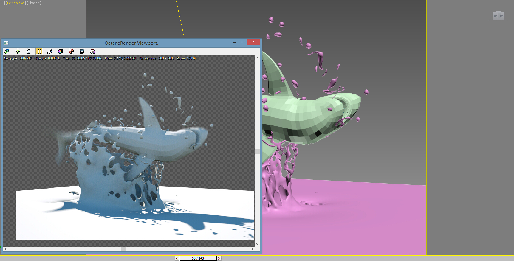

test with realflow abc file motion blur , still no any motion blur for the fluid(deform object)! but the shark did produce some motion blur(static object with no deform)...those ojects both are abc format! Should I send this test scene to you Mr.Karba??It's about 400MB~~
