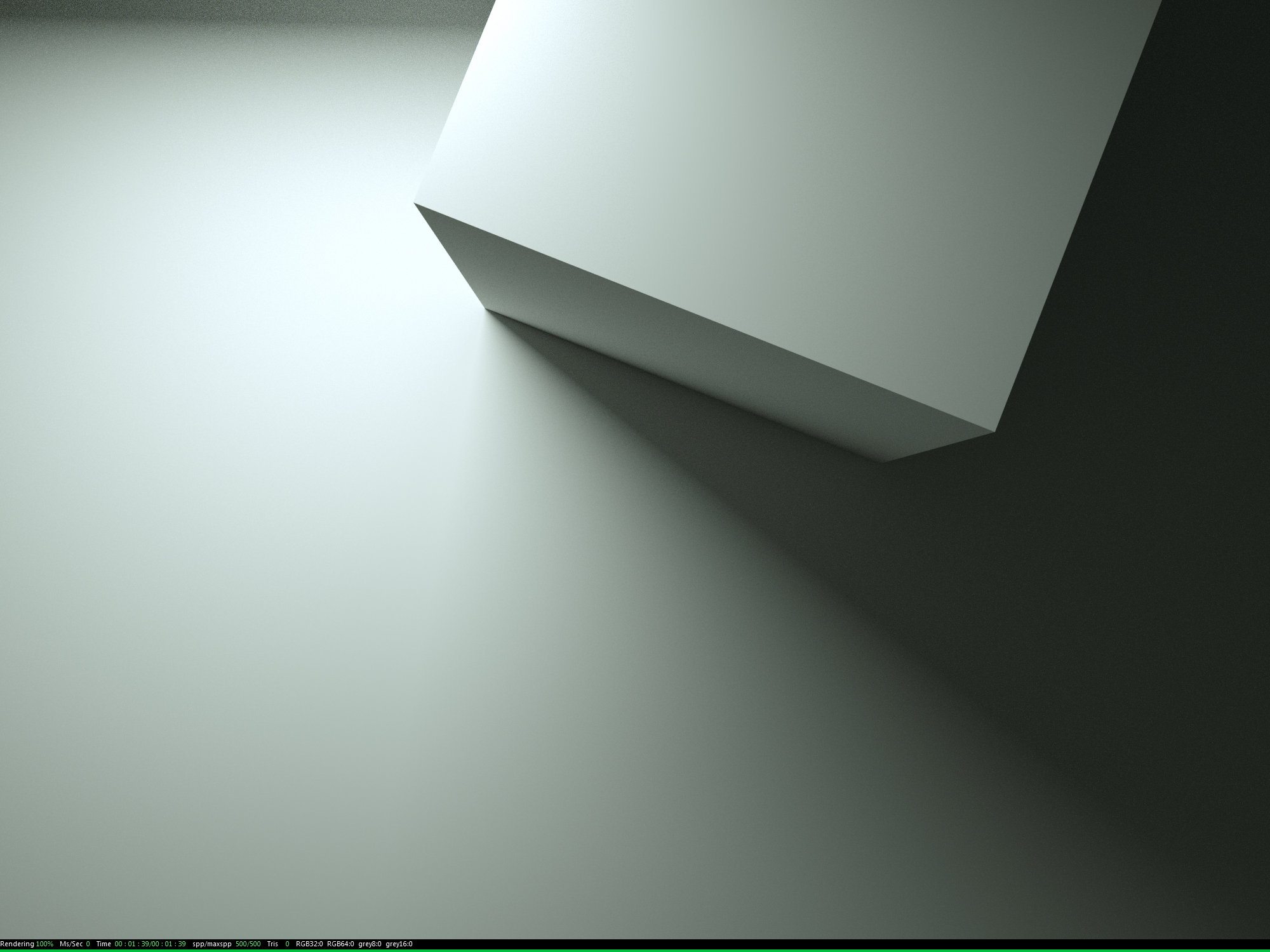

p.s. added files:

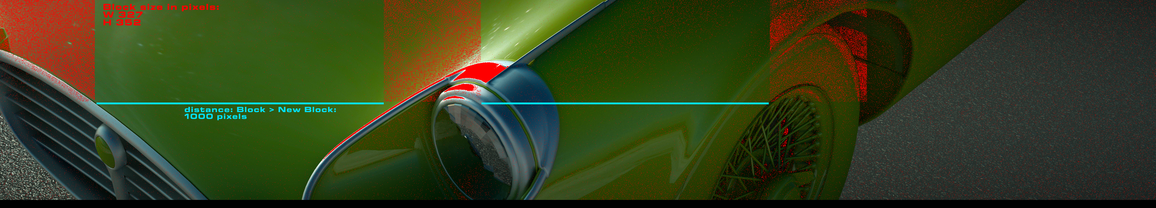

after restart+new scene. DL kernel. + Difference Matte to see difference
+ one 4000x720 Difference Matte and pixels count

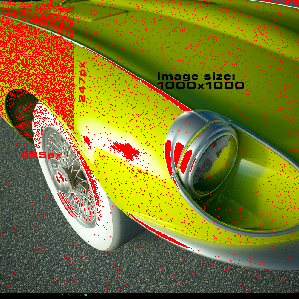

1000x1000 analysis
1000x1000 analysis

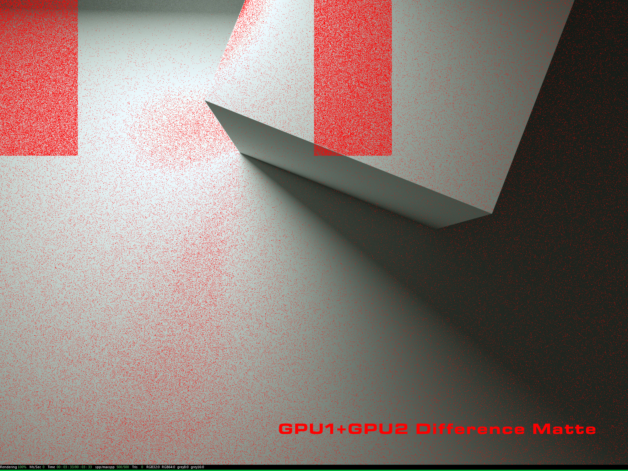

Difference Matte Both Samples

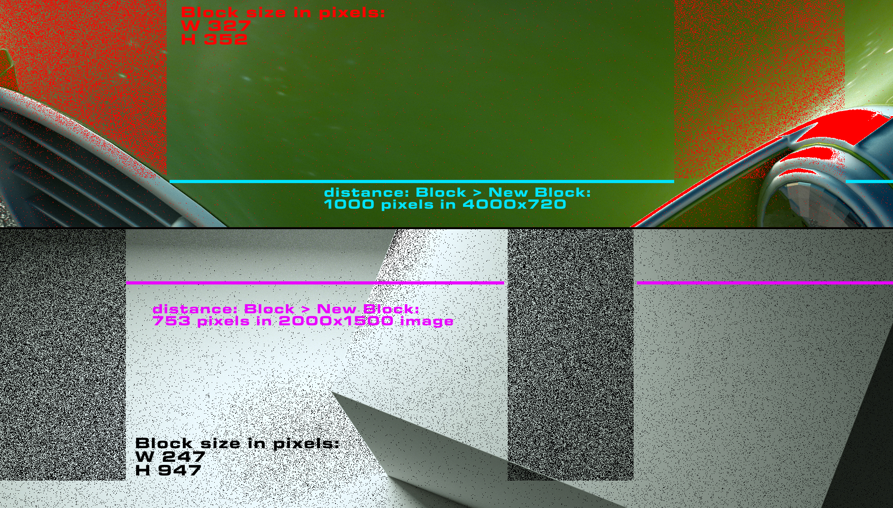

Difference Matte with bigger H Size and pixels count

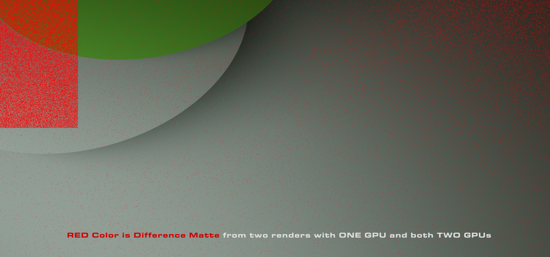

Difference Matte
Difference Matte
two gpu's
two gpu's

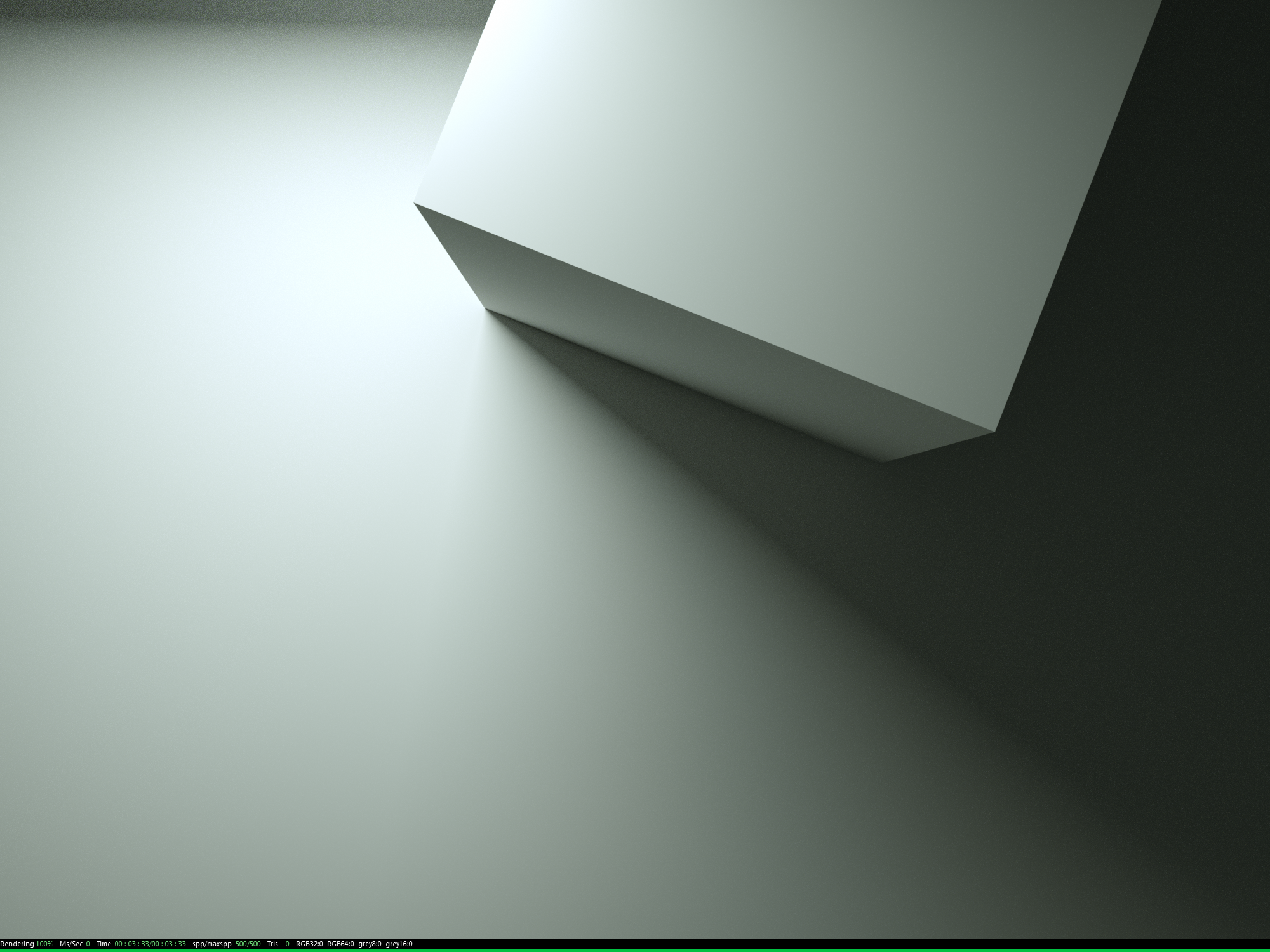

one gpu
one gpu

valters
Posts: 79
Joined: Sun Sep 07, 2014 3:18 pm
abstrax wrote:
valters wrote:nvidia driver: 344.16
gpu1: GTX 680
gpu2: GTX 760
OS: Windows 7 Pro x64
C4D: R15
octanePlugin: Version 2.12.1 - final (updated on 28.10.14)
p.s. added files:
Could you please send us a scene so we can reproduce this issue? Thanks.
One of them already posted "by valters » Mon Nov 03, 2014 4:18 pm"
and to see this issue you need to carefully look on image, as my previous post (images) is made in Adobe AfterEffects using Difference Matte with red background just to compare two images to clearly see that bug block. In usual render it looks just like I post on "by valters » Mon Nov 03, 2014 4:18 pm".
New test & scene file
new_day_test.zip
c4D SCENE
(110.35 KiB) Downloaded 281 times
valters
Posts: 79
valters wrote:
gpu1: GTX 680
gpu2: GTX 760
C4D: R15
p.s. added files:
New information:
I was render this scenes with different version and here is what i found:
Octane-for-C4D-2.06.0 - working fine. no this bug
Octane-for-C4D-2.06.1 - working fine. no this bug
Octane-for-C4D-2.10-test1 - working fine. no this bug
Octane-for-C4D-2.11.1-RC1 - not working fine. this block bug exists
Octane-for-C4D-2.11.1-RC2 - not working fine. this block bug exists
Octane-for-C4D-2.11.1 - not working fine. this block bug exists
Octane-for-C4D-2.11.2 - not working fine. this block bug exists
Octane-for-C4D-2.12.1 - not working fine. this block bug exists
so Octane-for-C4D-2.10-test1 for me was the last version without this bug.
valters
Posts: 79
Last Update. Everything is working fine if on octane plugin/devices setting uncheck all boxes with priority. Turning on any Pri. check box making this "block" bug with two GPUs.

I opened your scene on 3 GPUs with priority enabled and neither in the live preview nor in the final rendering I can see any blocky artifacts. Is there anything else I have to do to reproduce the problem?
valters
Posts: 79
abstrax wrote:
valters wrote:Last Update. Everything is working fine if on octane plugin/devices setting uncheck all boxes with priority. Turning on any Pri. check box making this "block" bug with two GPUs.
My steps was simple, I have just render two images, one with single gpu and second with both gpus. Both renders with the same amount of samples. After this just switching fast between two images I can see that block thing. Can you upload two rendered images, one with single card and second with two gpus and Pri. on?
valters
Posts: 79
valters wrote:
and here is link to mp4. I have record process https://mega.co.nz/#!Odw0SKiT!24pCqywNL ... -6-IX61bUg
