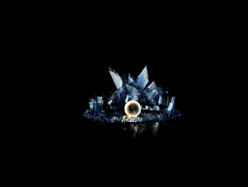

with area light at 3206.867 power barely doing anything
I add just a octane area light and it does nothing
add a daylight obj and turn power down - area light works in simple scene

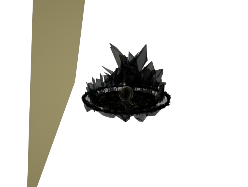

In this scene it only vaguely works no matter how much i turn up power or make the area light big it only affects the specular everything else stays black / power of 3200 on the area light thats ridiculous and its not really doing anything
when I turn up daylight everything brightens
what am i doing wrong ?
Also changing the time on the sun doesnt really seem to logically effect where the sun is or add shadows - do I have to add shadows turned on in light or does Octane suppose to add shadows on all lights no matter what ??
changed daylight to power of 5

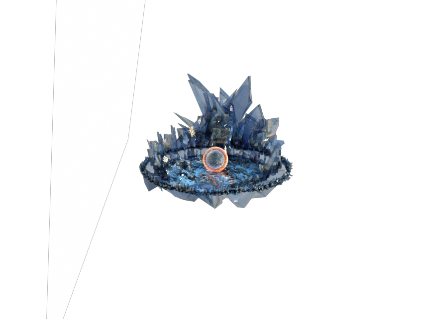

the only way i can get anything is
turn blackbody to texture
and turn power up to 10,000 - the image should be completly white blasted out

that yellow square on first picture is the arealight - its huge and the power is over 3000
