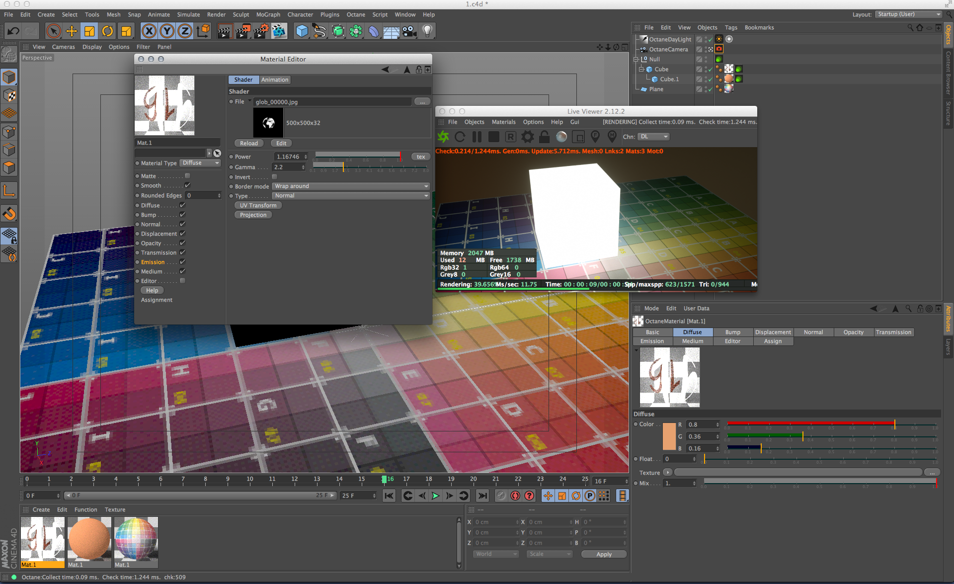

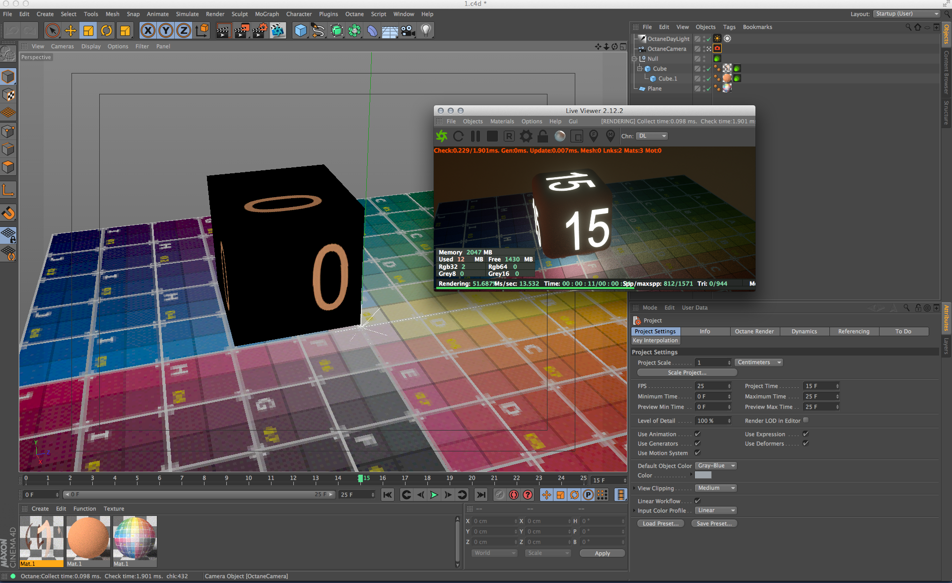

I am having the same issue here. I downloaded a scene from the forum (emistex.zip) which contains an animated texture.
I only change the animated texture that is very similar to the sample project and get a grey box!
Is that a bug?

Posts: 16068
Location: Türkiye
are you sure your image in under project path? check console output for a file error message

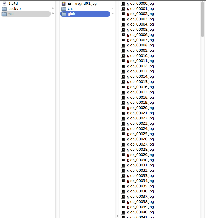

Monguilhott
Posts: 5
Joined: Sun Sep 28, 2014 5:40 pm
Yes, its in the project path. Where is the console output? Is the help/show octane log? Sorry beginner question.
