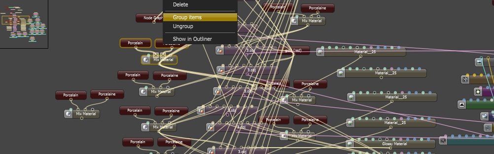

whersmy wrote:Though I get about 4 crashes every hour when adding materials in standalone
I assume you are working on OSX. What exactly do we have to do to reproduce the issue?
I`m on win7 x64.
Below is a screenshot of my node setup. Today I discovered the Group-node feature, which will make the scene less messy. I`ll retry with grouped nodes.
But the crashing of octane occures when clicking a mesh node (f.e. 3.obj) or the mix-material with porcelaine.
Octane 2022.1.1 nv535.98
x201t - gtx580 - egpu ec

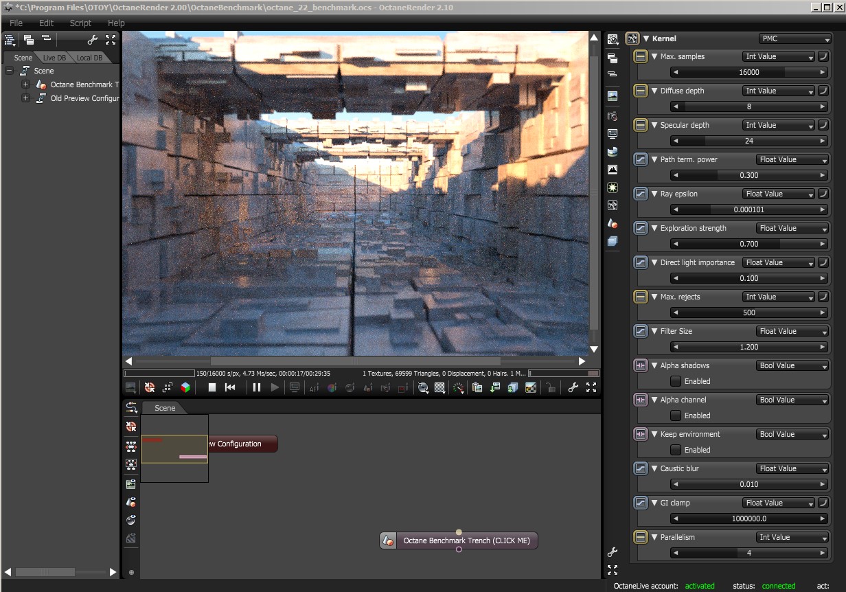

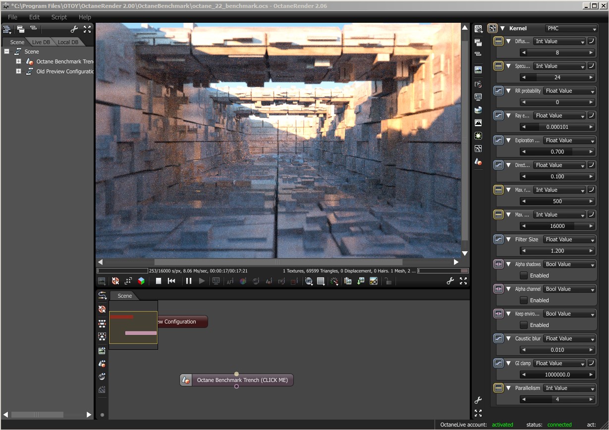

hi guys. in this version pmc became slower?
2.06 = 8.06 Ms/sec
2.10 = 4.73 Ms/sec
r9 3900x/64Gb/2070s/2070/win10x64/3dsmax2021

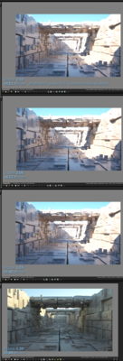

RobSteady
Posts: 618
Joined: Thu Jun 07, 2012 7:33 am
Benchmark 1.20 to 2.10
Don't know why I got this crazy result with my testscene...
Octane for 3ds Max v2.21.1 | i7-5930K | 32GB | 1 x GTX Titan Z + 2 x GTX 980 Ti
