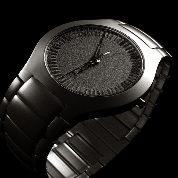

When you use models with transformations(scaling/rotation/translation), then you get errors.mlody47 wrote:hey smoothing is screwing up when I animate. In first frames its great and more frames more blackness on my renders
74/100 .
The same as Amplitudes watch.
