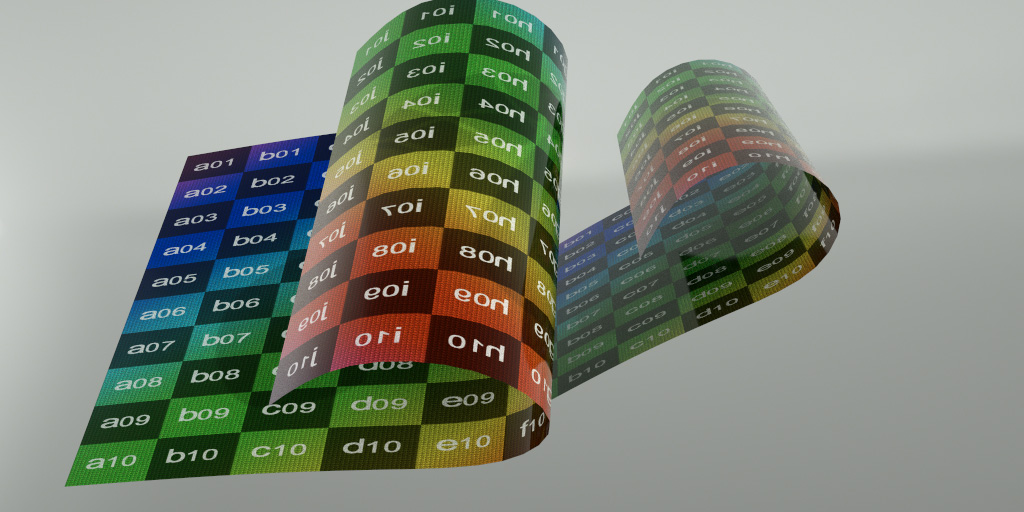

[attachment=3]all.jpg[/attachment]

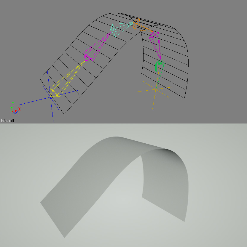

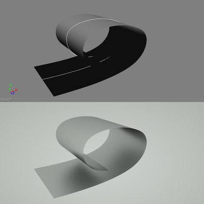

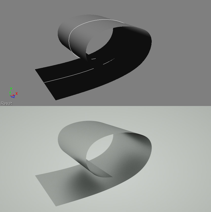

[attachment=4]curve.jpg[/attachment]
[attachment=5]skeleton.jpg[/attachment]

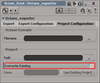

New:
Added a overwrite button like the blender one.
With that you can overwrite an existing project. Works only with stills.
After press the render frame button, it is unchecked and if you want to use it again, you must check it again.
See the image below...
