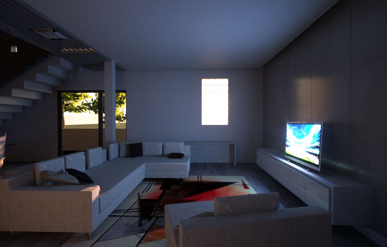

Here is a 3 minuts render (test for client, not final)
