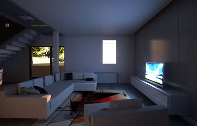

5) PMC and path tracing kernels produce a large number of noise dots in the dark zones of the model and it seems that they increase during the rendering. There is a method/setting to reduce them (Direct lighning produce a too fake result in nightime simulation)
Yes PMC and PT are the photorealistic kernels, there isn't "fast renders" in this kernels, but after lots of study of light and materils is possible to render in PT and PMC faster that any other render engine (night shoots are not easy with any rendering software)
There is no simple solution, because all scenes are different, every shoot need different settings.

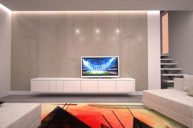

Here is a 3 minuts render (test for client, not final)
