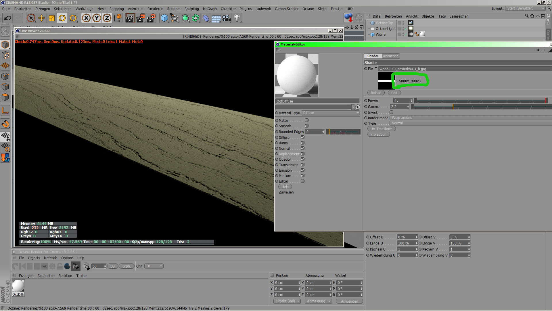

Posts: 188
Joined: Sun Sep 01, 2013 7:05 pm
Hi Achmed,
I believe, we speak sometimes again each other past. ;)
Therefore, here sometimes the pictures what I generally mean.
And why I ask whether it does not go still higher than 8192x8192.
256x256
256x256
512x512
512x512
1024x1024
1024x1024
2048x2048
2048x2048
4096x4096
4096x4096
8192x8192
8192x8192
15000x1800
15000x1800
With 8192x8192 many your details which are not to be seen with 4094x496 are shown.
Did it should not with 16384x16384 even more give to see?
Greetings Rudi
Posts: 16068
Location: Türkiye
8192 is limit of Octane. you should live with it
