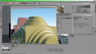

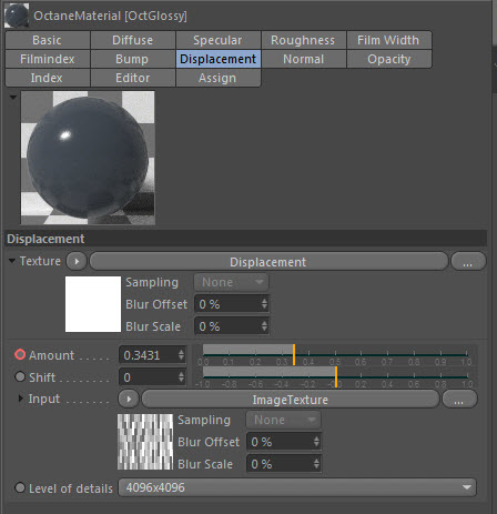

Hi, exactly didn't understand what are you doing. But first install standalone 2.05 and plugin 2.05. This is best for displacement.
No need any tutorials. Only use Octane materials for displacements. Use first a displacement node, and place a image to this. And activate displacement from material manager. Two images and a sample scene are below. That's all
Keep enjoy

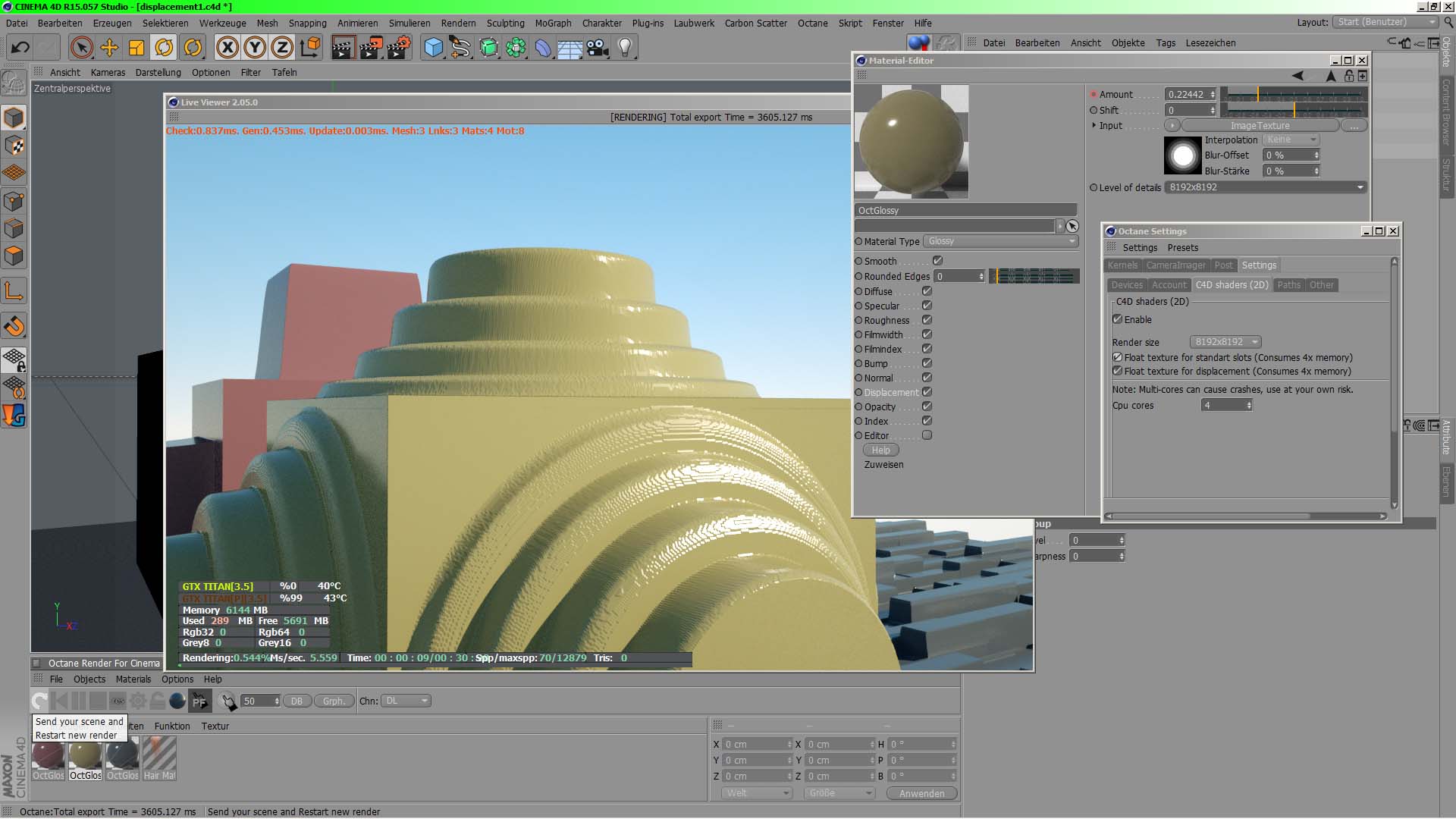

what I make then wrong because I still these stairs see with the Displacement . :(
Greetings Rudi
Posts: 16068
Location: Türkiye

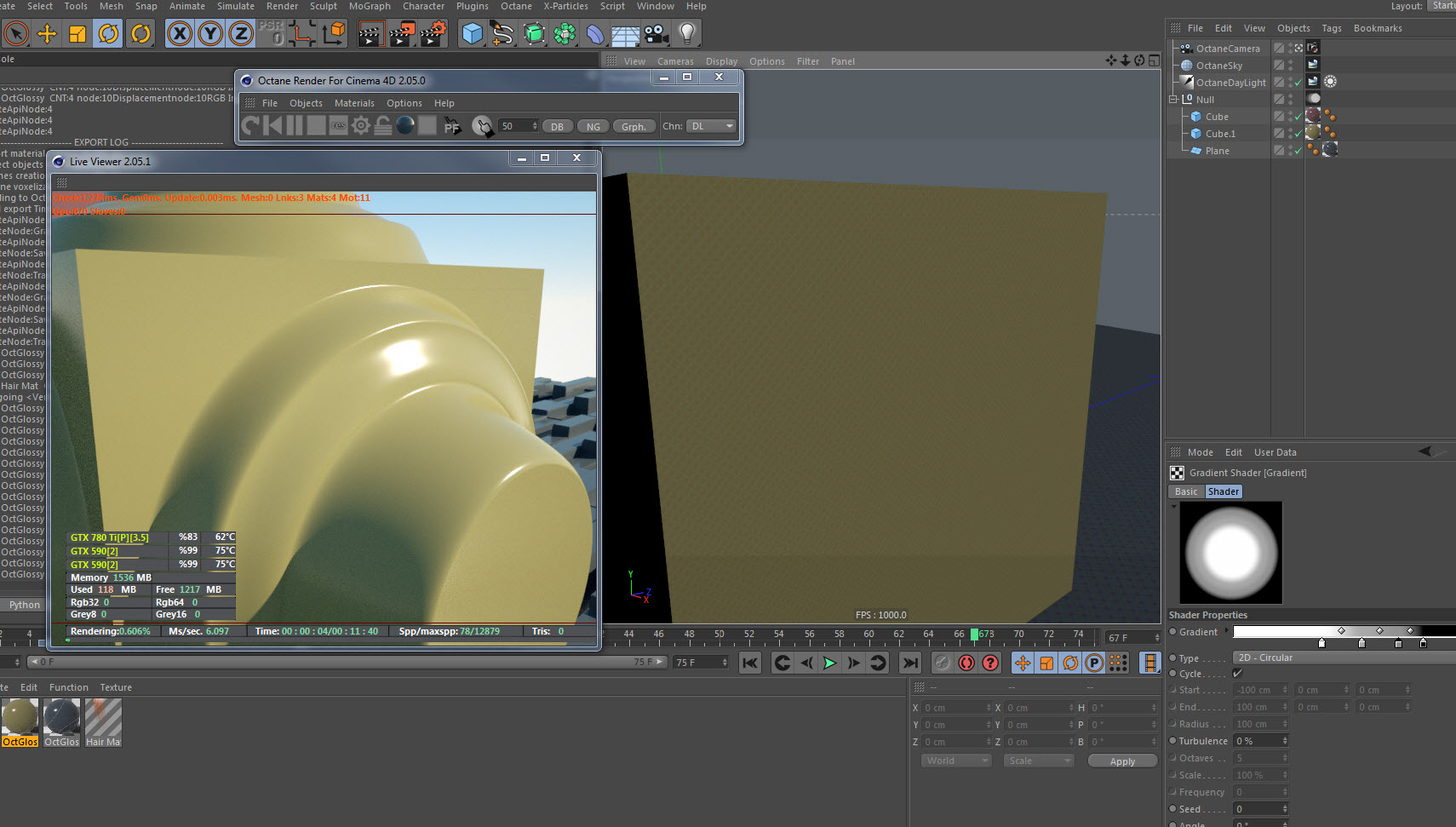

your are still expecting magic via a low res image. Check my picture, displacement source image which is produced by a gradient
