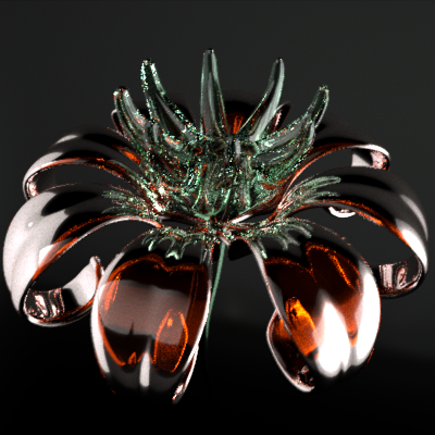

Here is a render done using Yafray : http://marcondes.tv/files/gimgs/59_flower09.jpg
I've been trying to get something similar, but no way.
All specular material are as if they were completely opaque!

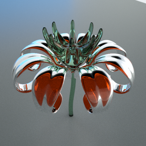

I attach to this post an ugly flowerish object that I've done with Blender and a rendered image o it.
Can you please help me to setup some beautifull glass material?

Maybe some info (or a screenshot) of your material might help, as well as your render settings. We also have no idea about how you're lighting the object.

it seems it come from your mesh normals !... i've made a "recalculate normal outside" on the flower mesh. and all seems going well :D

Yesss, thank you!
I've noticed the petals were black when doing clay render.
Now it's okay, gonna try make some nice glass flowers.
