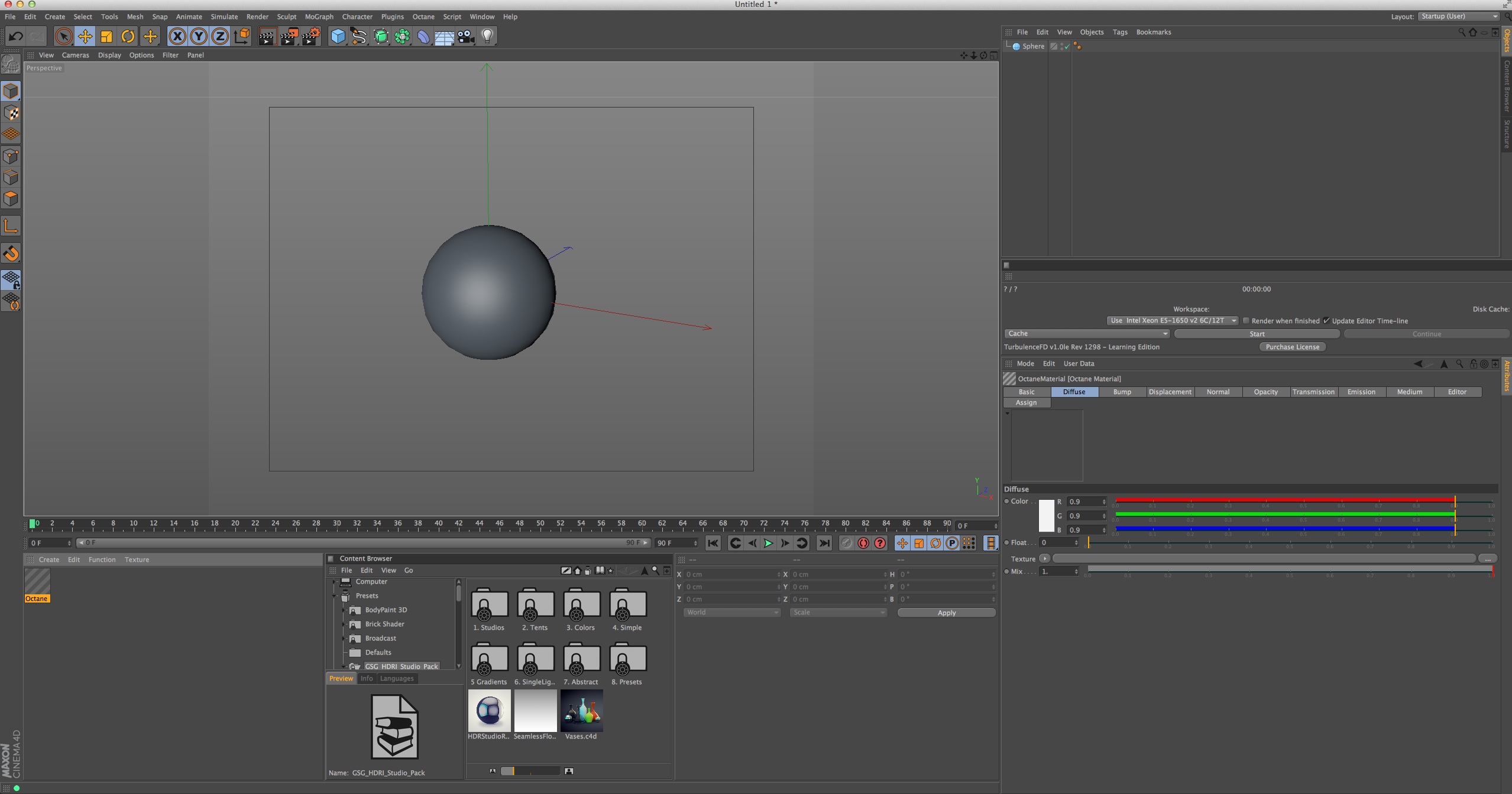

I just downloaded the demo version, and I am using it in conjunction with C4D R15, I installed the plugin correctly and everything is working in C4D. Except for when I try to create a material, nothing shows up. I get a new material icon in the material library, but it is completely invisible in the display icon. furthermore, when I apply that to any object, nothing shows up in any render with Octane. please let me know what to do, thanks!!
basic octane material added to library

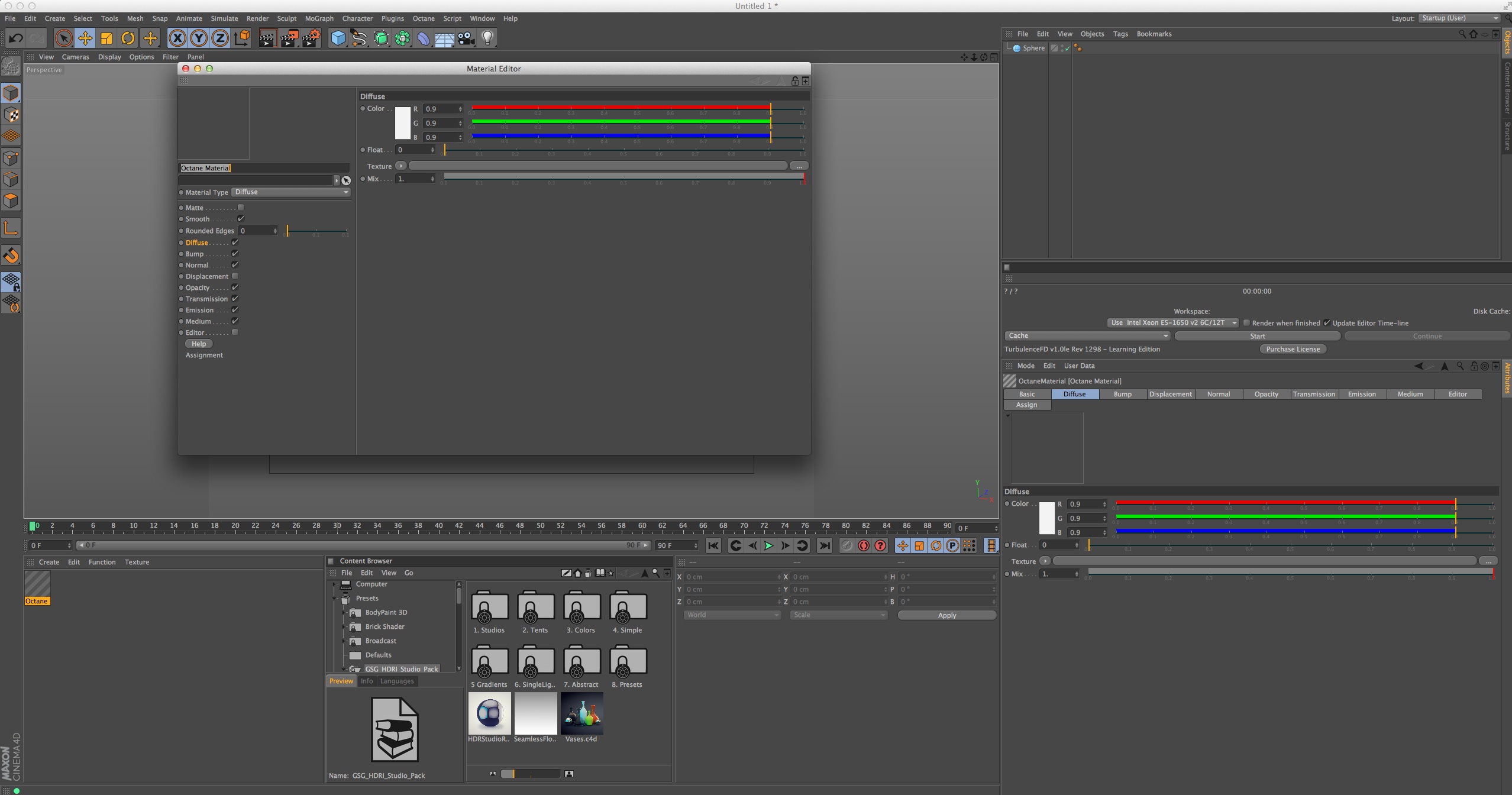

view from the material editor

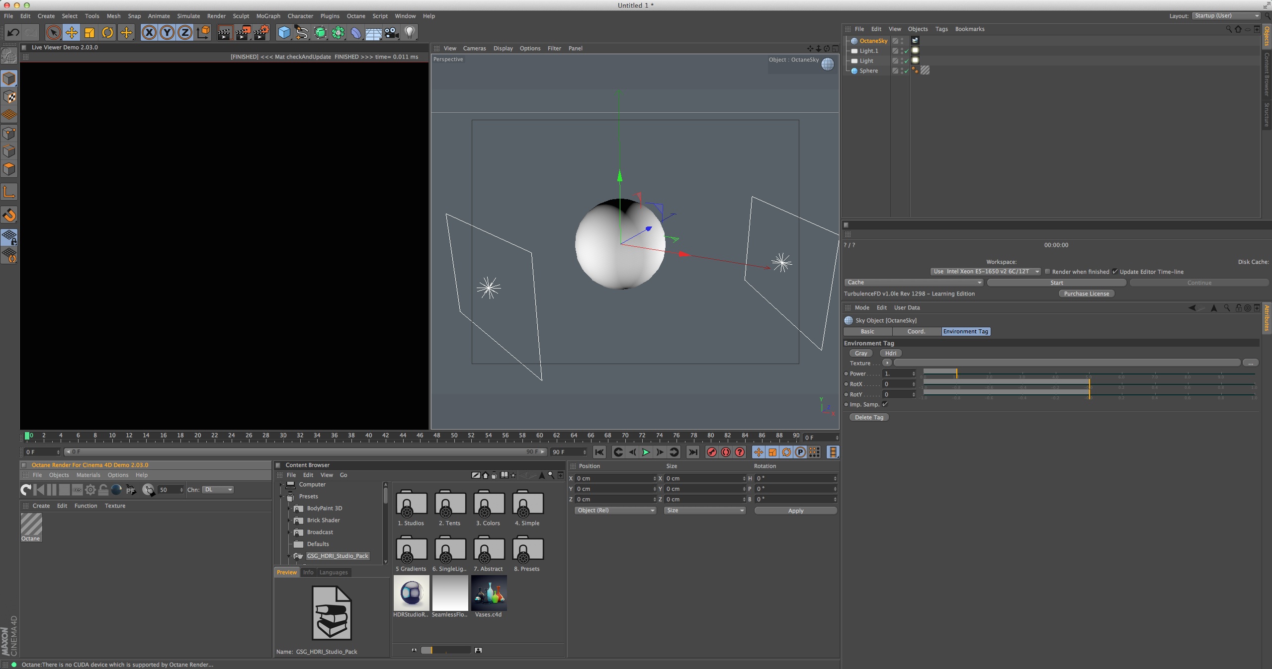

Basic octane scene with nothing rendering

do you have a cuda capable nvidia graphics card? Also you may need at least driver 335...
Whad do you see in devices section of Octane Settings?

Look your screenshot, your videocard hasn't CUDA support - OR requires NV GeForce with compute capability (CC) 2.0 or newer version of CC.
