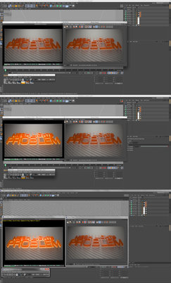

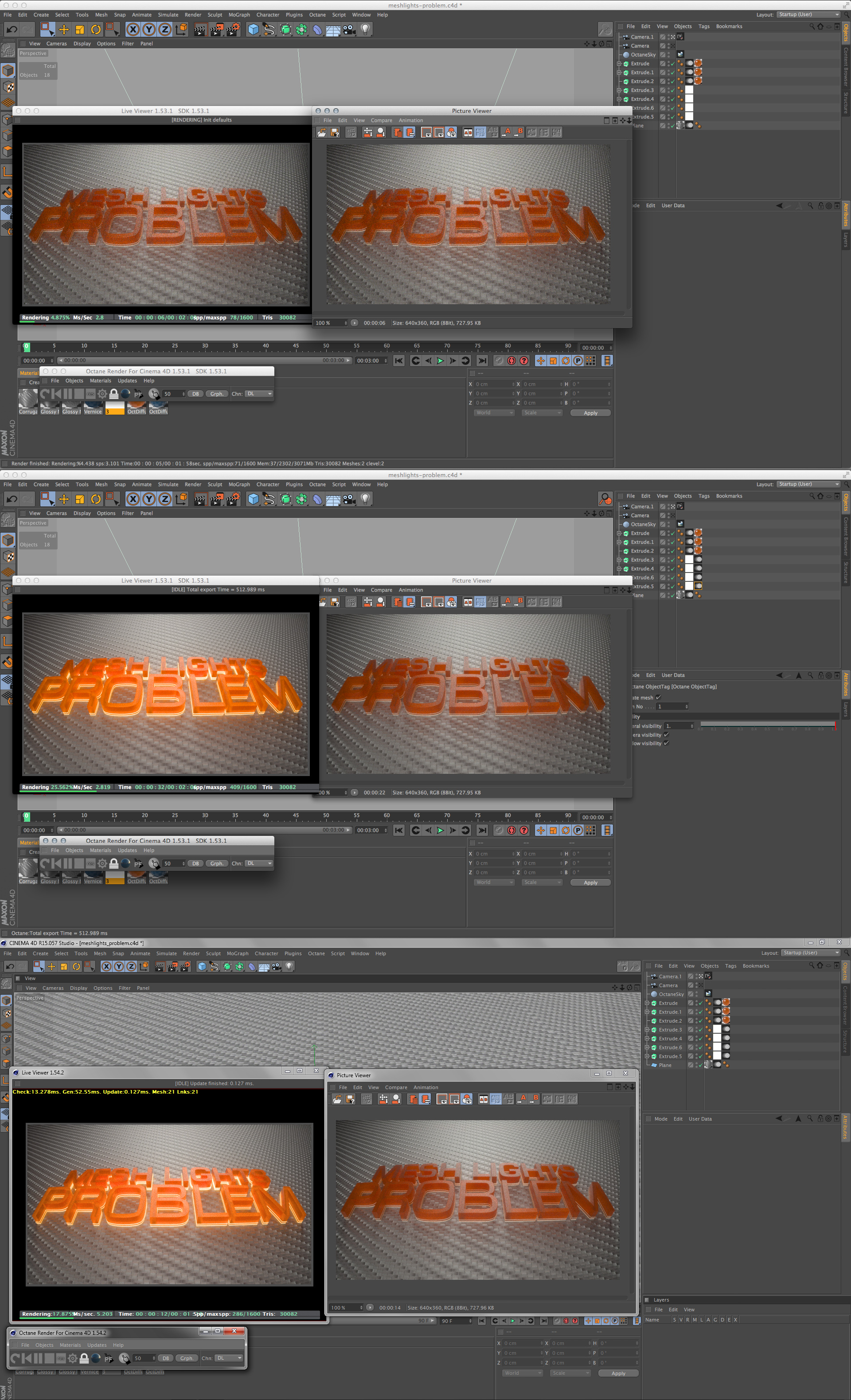

milanm
Posts: 261
Joined: Tue Apr 30, 2013 7:23 pm
Hi Ahmet
I can confirm the same problem here. On Mac and Windows in two different versions of plugin.
meshlights_problem.zip
(1.76 MiB) Downloaded 171 times
This is a bit off topic but when can we have a stable version of C4DOctane plugin? I mean any version, just STABLE and FINAL? New features are nice in 2.0 but now all usable versions of plugin are beta. This is frustrating for professional work. Right now i have to keep all versions of the plugin for each job just to make sure i can open the project in the future. Just saying.
By the way congratulations on the 2.0 release ;)
Milan
edit:updated scene file to include object tags.
