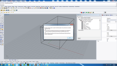

First it said the geometry is to large and I need to increase the number of polygons....I tried doing so but it never seemed to change the actual number.
Then when I clicked render the same error appeared and has been coming up whenever I click render even in different Rhino scenes.
What did you increase the number of polygons to?
If you put a sufficiently large number in for the max polygons, it will be too large to fit in your RAM, and will probably pop an error, even on the smallest scene (since it will pre-allocate the "max polygons" amount of memory). The default max polygons is set to 10 million, and I would have thought it would be incredibly rare for a Rhino scene to need more than this. I think Octane's limit is around 28 million polygons.

You were right. I checked the polygon size a while back and it was nowhere near 28 million, so definitely not the problem.
I started work a few weeks ago and installed octane for Rhino on their computers and the same error came up. I am really unsure as to why it is doing it. My Octane for Rhino still will not work so I will try a reinstall quickly to see if that fixes it.....I don't think there is much else I can do.

....I just reinstalled and another error came up.

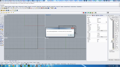

On my home computer I re-installed Octane for Rhino again and double checked the settings we have spoken about over the past few months and found that the polygon setting was in fact way too large, somewhere in the 100's of millions. I switched it back to 10 million and it has been working flawlessly. Maybe when I changed the setting previously it didn't reset back....or I simply didn't click the apply button. hmmm
The error has been appearing on my computer at work also but it does continue to work after clicking the 'ok' button. The error appears when you click 'open vewport', although it doesn't happen all the time its quite random. I will keep you update, atleast its working though.
