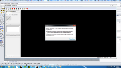

I installed OctaneRender for Rhino 5.0 today, and all was going well until the error appeared when I clicked the render bar. It happens in both 'open viewport' and 'render' mode. There is no info on this so I have come here to hopefully find some answers. I am currently working on a few designs so would be good if I could knock this error on the head.

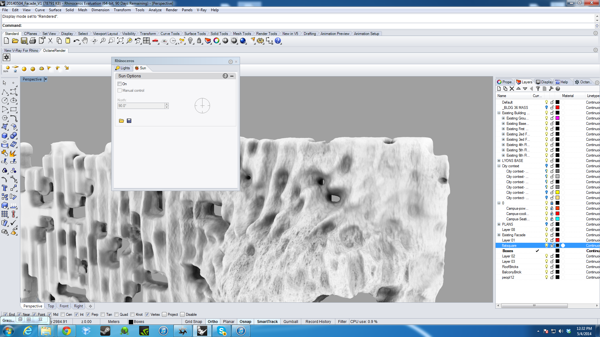

Are you able to post a screenshot of the Rhino->Render->Panels->Lights and Sun settings pls?

Hi Paul,
Is this what you mean? thanks for helping me out here.
Everything seems OK there. Would it be possible to send me the scene pls? Email address is paul at physicalc-software dot com.

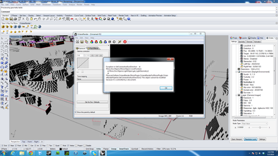

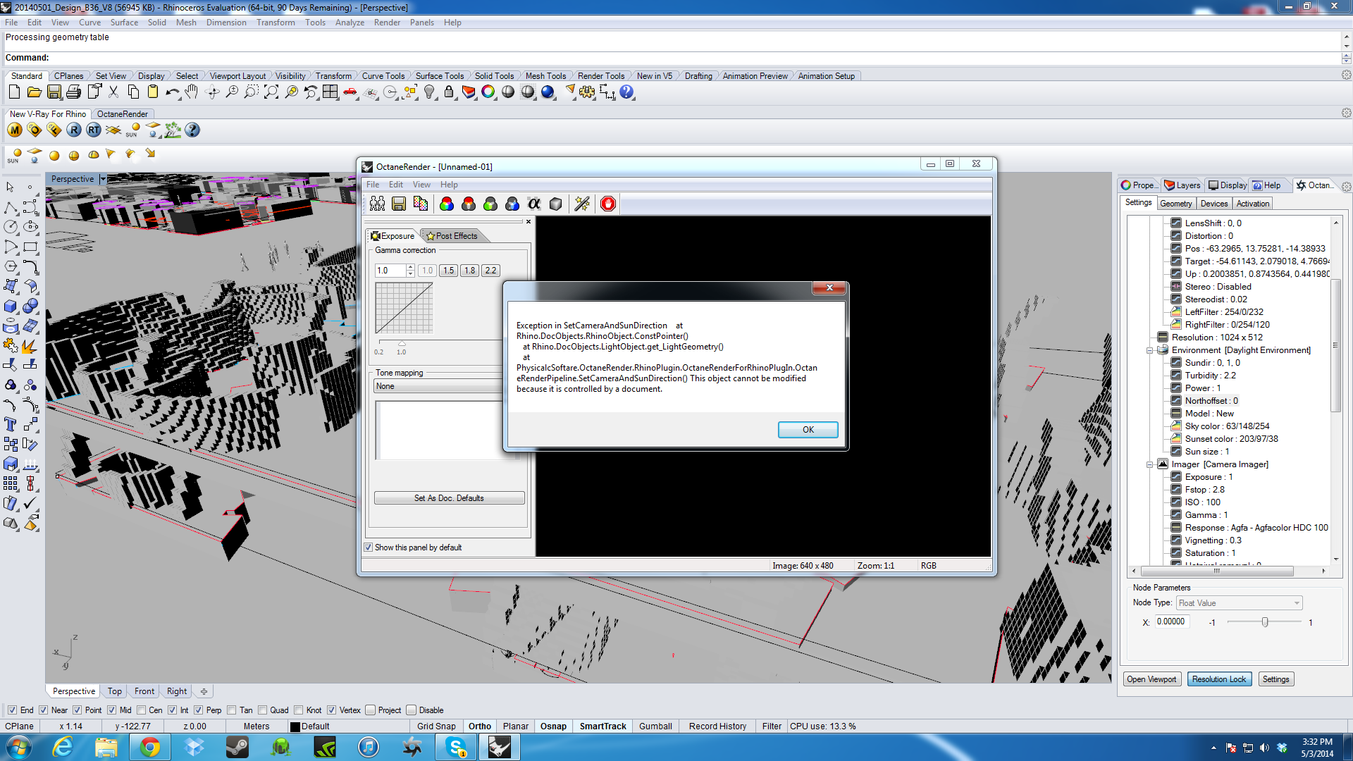

Sorry to do this again. But when I began rendering tonight the error appeared again on the screen.
First it said the geometry is to large and I need to increase the number of polygons....I tried doing so but it never seemed to change the actual number.
Then when I clicked render the same error appeared and has been coming up whenever I click render even in different Rhino scenes.
