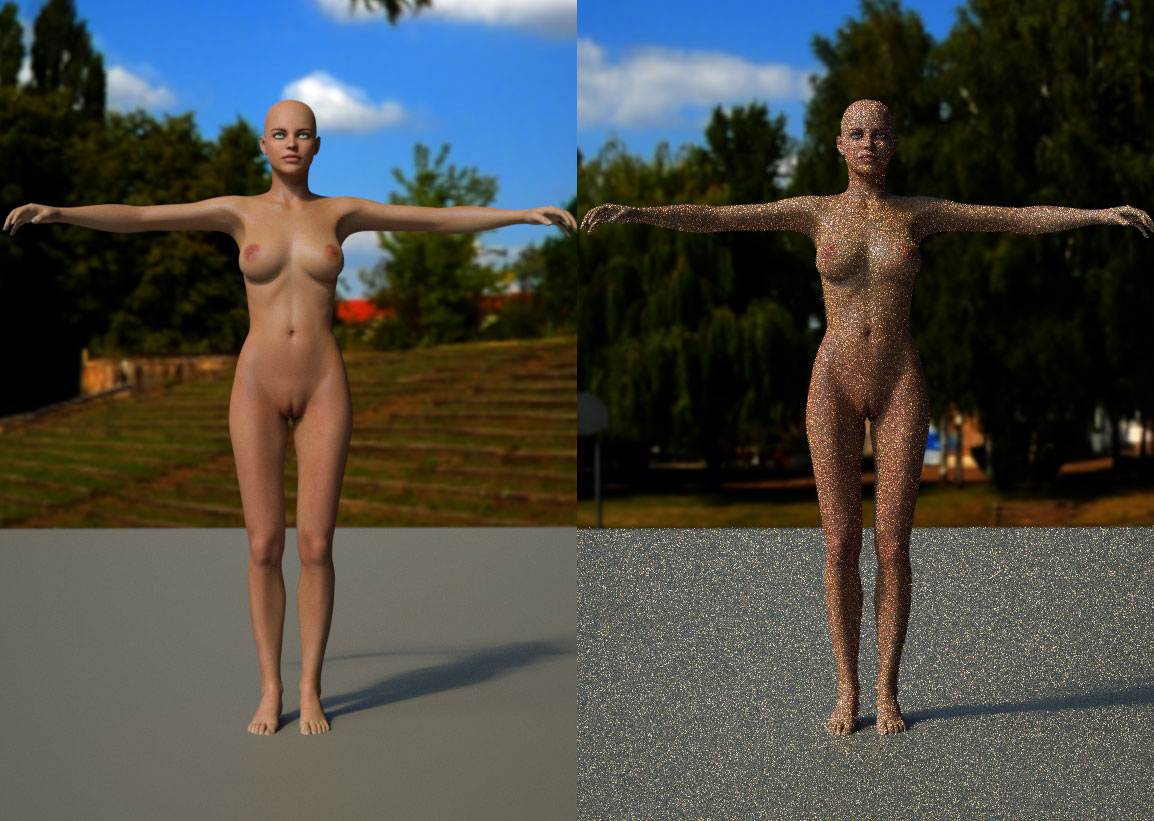

When I use the texture environment comes a perfect picture. As soon as I change the rotation remains the image grainy even after x samples. Only when I press refresh a normal render builds up. This is very laborious in complex scenes because I like to illuminate with texture environment and the rotation is essential.

Have you deleted you default rendertarget settings as recommended in the release notes at the top of this thread? It's possible that your default rendertarget is a 1.20 version, which is not working right with 1.25.When I use the texture environment comes a perfect picture. As soon as I change the rotation remains the image grainy even after x samples. Only when I press refresh a normal render builds up. This is very laborious in complex scenes because I like to illuminate with texture environment and the rotation is essential.

I have deleted the default render setings (in the release notes I could not read anything about default render target settings, maybe I'm blind) but the problem still exists.face_off wrote:Have you deleted you default rendertarget settings as recommended in the release notes at the top of this thread? It's possible that your default rendertarget is a 1.20 version, which is not working right with 1.25.When I use the texture environment comes a perfect picture. As soon as I change the rotation remains the image grainy even after x samples. Only when I press refresh a normal render builds up. This is very laborious in complex scenes because I like to illuminate with texture environment and the rotation is essential.

You are right - I appear to have deleted that line!I have deleted the default render setings (in the release notes I could not read anything about default render target settings, maybe I'm blind) but the problem still exists.
Could you pls try exporting the scene to Octane Standalone, and then see if rotating the map in Standalone is giving you the same issue? That way we will know if it's an Octane issue or a plugin issue.
Also, does turning Importance Sampling off then on help?
Paul

I have exported the scene to OctaneRender 1.26, but the problem was there 1:1 as in the plugin. But off and on the importance sampling according to a rotation helps to smooth the image.face_off wrote:You are right - I appear to have deleted that line!I have deleted the default render setings (in the release notes I could not read anything about default render target settings, maybe I'm blind) but the problem still exists.
Paul
But I think it should still work even without such actions.
