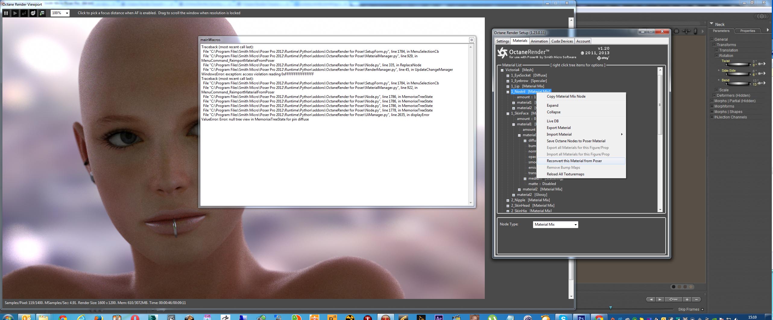

First kill to me! after trying reload reconvert this material from poser come up with this error
ps then it will crash poser pro 2014
ps there was this errror message as well
Traceback (most recent call last):
File "C:\Program Files\Smith Micro\Poser Pro 2012\Runtime\Python\addons\OctaneRender for Poser\SetupForm.py", line 1784, in MenuSelectionCb
File "C:\Program Files\Smith Micro\Poser Pro 2012\Runtime\Python\addons\OctaneRender for Poser\MaterialManager.py", line 929, in MenuCommand_ReimportMaterialFromPoser
File "C:\Program Files\Smith Micro\Poser Pro 2012\Runtime\Python\addons\OctaneRender for Poser\Node.py", line 335, in ReplaceNode
File "C:\Program Files\Smith Micro\Poser Pro 2012\Runtime\Python\addons\OctaneRender for Poser\RenderManager.py", line 45, in UpdateChangeManager
WindowsError: exception: access violation reading 0xFFFFFFFFFFFFFFFF
oh and this error
File "C:\Program Files\Smith Micro\Poser Pro 2012\Runtime\Python\addons\OctaneRender for Poser\SetupForm.py", line 1781, in MenuSelectionCb
File "C:\Program Files\Smith Micro\Poser Pro 2012\Runtime\Python\addons\OctaneRender for Poser\MaterialManager.py", line 1544, in MenuCommand_ImportMaterialRetainMaps
File "C:\Program Files\Smith Micro\Poser Pro 2012\Runtime\Python\addons\OctaneRender for Poser\MaterialManager.py", line 1496, in Import
File "C:\Program Files\Smith Micro\Poser Pro 2012\Runtime\Python\addons\OctaneRender for Poser\Node.py", line 1786, in MemoriseTreeState
File "C:\Program Files\Smith Micro\Poser Pro 2012\Runtime\Python\addons\OctaneRender for Poser\Node.py", line 1778, in MemoriseTreeState
File "C:\Program Files\Smith Micro\Poser Pro 2012\Runtime\Python\addons\OctaneRender for Poser\UiManager.py", line 2635, in displayError
ValueError: Error: null tree view in MemoriseTreeState for pin diffuse
W7 64 bit |I7-3970X | GTX 780 X2(6GB) GTX 780TI X2 | 64 GB DDR3 RAM
