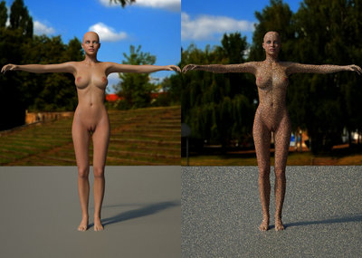

When I use the texture environment comes a perfect picture. As soon as I change the rotation remains the image grainy even after x samples. Only when I press refresh a normal render builds up. This is very laborious in complex scenes because I like to illuminate with texture environment and the rotation is essential.

Before and after rotation, about 422 samples
Have you deleted you default rendertarget settings as recommended in the release notes at the top of this thread? It's possible that your default rendertarget is a 1.20 version, which is not working right with 1.25.

I have deleted the default render setings (in the release notes I could not read anything about default render target settings, maybe I'm blind) but the problem still exists.
You are right - I appear to have deleted that line!
Could you pls try exporting the scene to Octane Standalone, and then see if rotating the map in Standalone is giving you the same issue? That way we will know if it's an Octane issue or a plugin issue.
Also, does turning Importance Sampling off then on help?

I have exported the scene to OctaneRender 1.26, but the problem was there 1:1 as in the plugin. But off and on the importance sampling according to a rotation helps to smooth the image.
But I think it should still work even without such actions.
