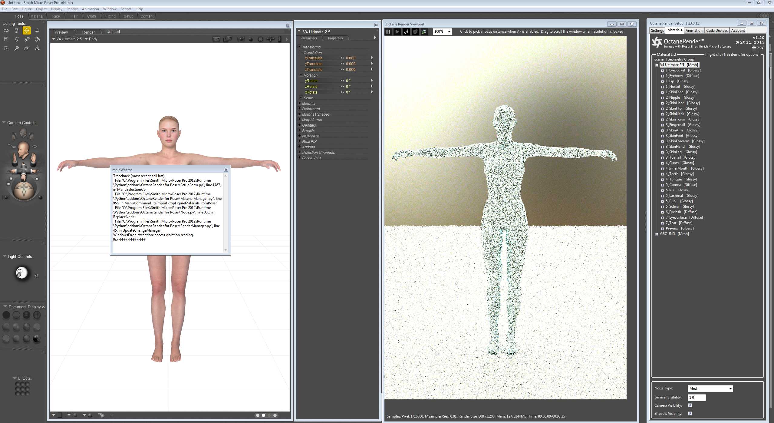

Deane - can you provide a screenshot with the entire error msg pls?May have to go back to the previous version until some of these issues are resolved.
Does it happen when the viewport is opened, closed or either?
Does the material you are trying to convert have Octane nodes saved to the Poser material?
The old version was not actually setting rayepsilon to 0 when you entered 0 - it was setting it to something like 0.00001. Now 0 is truely 0. Does entering '1e-05' work?Why... when setting 'rayepsilon' to 0.00 now produce blotchy textures... it never use to and was a great way to hide hair model clashes and eye socket dark patches.
Paul
I am unable to reproduce this issue. Can you pls list the steps taken to get this error? Preferable on the default Andy scene.Found something harmless, thought I'd mention it regardless. When saving a pose to the Poser library while the Octane plugin is open, I just got this message from Main Wacros window: Exception in OctaneRender for Poser objectsAdded
Paul
Um... the entire error message either scrolls off to oblivion or I'm missing where to capture it.face_off wrote:Deane - can you provide a screenshot with the entire error msg pls?May have to go back to the previous version until some of these issues are resolved.
Paul
But since trying it again... I now get the following error message... probably means I need to restart the system or buy another graphics card.
This happens with the viewport opened or closed.
And it looks like so far setting rayepsilon to 0.00001 fixes the problems... further testing needed.
Ok... sorted it a bit... only occurs with 'London'... this product http://www.renderosity.com/mod/bcs/the- ... 4-2/97977/
selecting HR texture in Poser and then updating in Octane causes it to spit the dummy.
On the second attempt trying to create the error again after a reboot. The same error message appear as shown above and Poser proceeded to hang and Windows said it wasn't responding... big dump!

I cannot reproduce this error. I /think/ it is related to materials being "external" nodes - but the 2 materials attached to the material mix need to be "internal". It may also be related to loading 1.20 version pz3 files. Can you reproduce this by applying that material to Andy, then re-converting from Poser? If you can provide a reproduceable set of steps, then I can track it down.First kill to me! after trying reload reconvert this material from poser come up with this error
ps then it will crash poser pro 2014
ps there was this errror message as well
Traceback (most recent call last):
File "C:\Program Files\Smith Micro\Poser Pro 2012\Runtime\Python\addons\OctaneRender for Poser\SetupForm.py", line 1784, in MenuSelectionCb
File "C:\Program Files\Smith Micro\Poser Pro 2012\Runtime\Python\addons\OctaneRender for Poser\MaterialManager.py", line 929, in MenuCommand_ReimportMaterialFromPoser
File "C:\Program Files\Smith Micro\Poser Pro 2012\Runtime\Python\addons\OctaneRender for Poser\Node.py", line 335, in ReplaceNode
File "C:\Program Files\Smith Micro\Poser Pro 2012\Runtime\Python\addons\OctaneRender for Poser\RenderManager.py", line 45, in UpdateChangeManager
WindowsError: exception: access violation reading 0xFFFFFFFFFFFFFFFF
