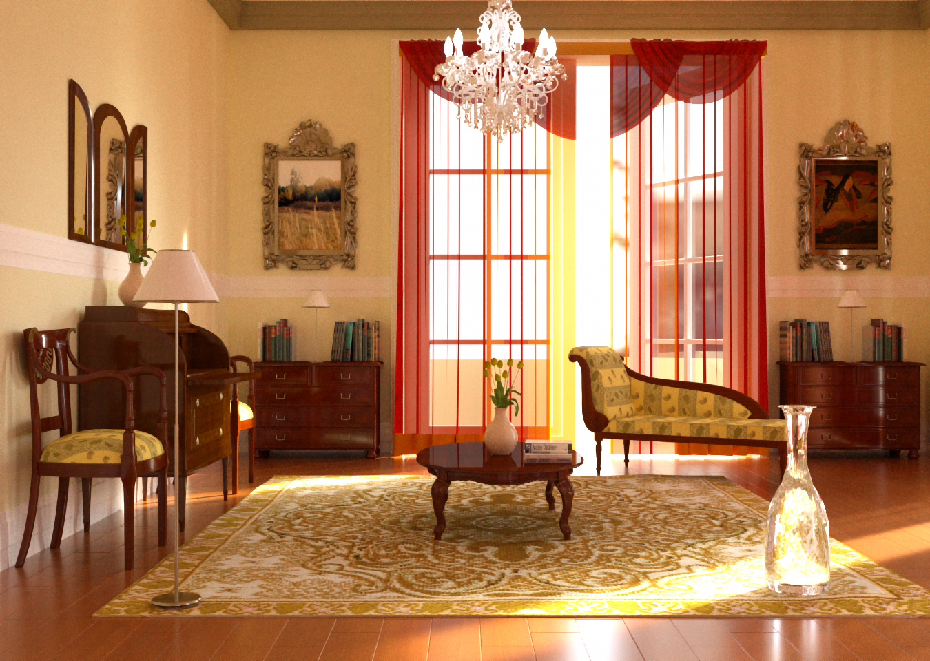

merid888
size 1350 x 960 px, DL+AO4. maxsamples 1500, time 181 seconds, rendered into 1 gtx690, standalone 1.20 x64
regards
nuno1980
Posts: 794
Joined: Sat Dec 18, 2010 10:04 pm
Not very good because bit unrealistic... Therefore, you should change kernel recommendly from DL to PMC due to your excellent GTX 690 (2 GPU's) and to look glasses (speculars). :)

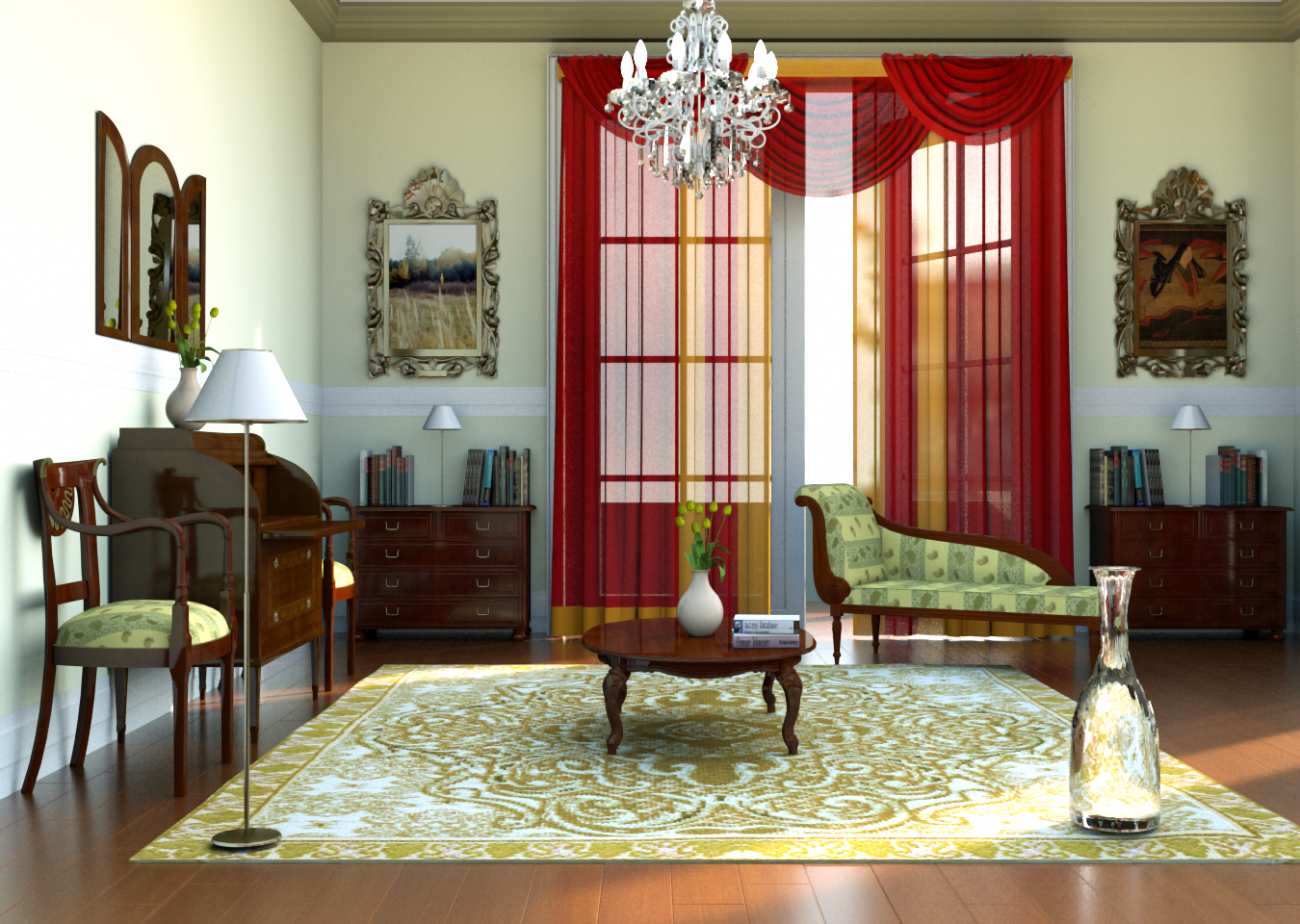

PMC settings:
maxrejects - 2,000
caustic_blur - 0.0000
- NOTICE: Please do not change from rest defaults (should keep maxsamples 16,000; maxdepth 16;...).
good luck ;)

merid888
thank you, i'll test right now with this values
i'll upload new image
ohhh my ... is a lot time 3 hours 16 minutes to do the same image with pcm, definitely is not a good option pmc to commercial images !!!

Yes! Yes! - Excellent option = realistic for PMC. :)
But...
Current imager:
-ISO "80.0000" to "90.0000" from "100.0000", if too light
-gamma "2.2000"
-camera response "Misc." -> "dscs315_2"
Wait your better screenshot... :)
