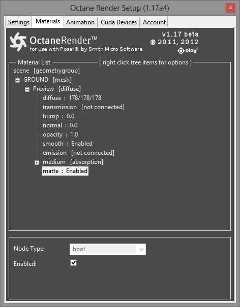

I dont see much in the manual about a shadow catcher. Has this been implemented yet?
thanks!

Select the diffuse node and check the "matte" option.

Thanks Miru,
but unfortunately, I cant find what your referring to here.

The matte flag turns the material into a shadow catcher

thanks Miru, and for pic also!
I see one problem. I dont have those last 2 settings: medium and matte.
Am I supposed to add a ground material to be able to see that? I think I had the ground invisible
. Do I have to have ground visible to get a shadow? I know that sounds funny maybe, but I just was
hoping for a shadow to add to a future ground.
Convert your material to "diffuse". Those pins are not present on "glossy" or "specular" materials.
I haven't used "matte" myself, but I'm guessing you will need the Poser ground visible.

gold wrote: Am I supposed to add a ground material to be able to see that? I think I had the ground invisible
It doesn't have to be the ground plane, you can assign the diffuse matte material on any object/material you like.
But if you use the ground, it has to be visible, yes. (Otherwise it wouldn't be transferred to the plugin) ;)
