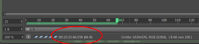

Ok, so now my animation with the picture manager stuck on frame 66 (0.6.7c), gpus are unloaded and nothing happens, staying there till 22 Minutes now. No Crash, but Render Hang Up... I can close the picture Manager and start again or resume... but loose a lot of time, if I don`t babysitt my render.
Will try the same scene without the textures later...

ChrisVis wrote:Ok, so now my animation with the picture manager stuck on frame 66 (0.6.7c), gpus are unloaded and nothing happens, staying there till 22 Minutes now. No Crash, but Render Hang Up... I can close the picture Manager and start again or resume... but loose a lot of time, if I don`t babysitt my render.
ok soo we have still some problems, i must checking and testing more. is it occurred with which settings?
I have the exact same problem.
