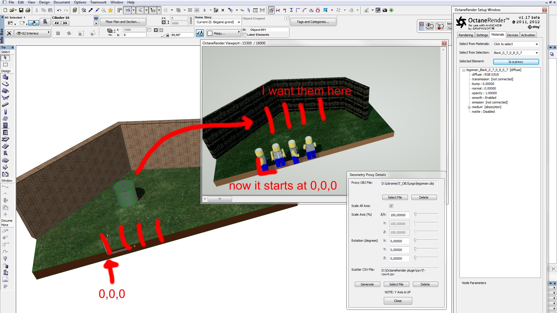

Hi Paul,
Right now the proxy always starts at 0,0,0
does not matter where the AC object is located.
I think that works OK when using generate scattering by using a mesh.
But when using a csv file I don't get the result I am looking for. I made a simple csv file for 4 objects in a row rotated (y-axis) on the spot.
I know this is discussed in an earlier post... and what again is the reason for always starting at 0,0,0?
I am thinking of a solution to this... maybe if you are able to use the object coordinate and transposition the proxy to the AC object location?
I informed at the Dutch Archicad distributor and I cannot 'read'the coordinates of an object at this moment. They will ask the GDL developers if it is possible to add it to the scheme lists and they will get back to me.
But... there is one tool (*) that has the coordinates of a position: Can you do something with that object?
Another solution would be (like in the standalone) is to have another node for translation,
to move the total scattering... maybe even use the coordinate-tool (*) to do that!
greetz, Jeroen

Hi JeroenI know this is discussed in an earlier post... and what again is the reason for always starting at 0,0,0?
If there is no scattering file for a proxy, the proxy position is taken from the host object position. If there is a scattering file, the host object position is set to 0,0,0, and any position change needs to be in the scatter transforms. So to move your 4 objects in the example you provided, add the position change to the 4 transforms, or do NOT scatter, and simply proxy 4 object.
It must be this way, otherwise when you scatter 1000 trees, you will have to position the host object to 0,0,0 and people are not going to know to do that, so the plugin must do it.
Also, keep in mind that the plugin is not trying to replace modelling apps or Octane Standalone. It is specifically for architectural visualisations, so the scattering is meant for grass, trees, etc, and I think the current implementation is streamlined for that. But there will always be limits, and if you hit those limits you will need to look at exporting the scene to Standalone.
Paul

Yes, I totally follow you
I needed to get my brains in oreder again why and how it is as it is now.
And you are right.. It does not have to be the same as in Standalone... I was to conservative on that
This way of having the csv to the origin has also a nice workflow in having the possibilty of making a csv with coordinates
And in the example of the 4 in a row located it is also easy to add the coordinates in the csv if ever necessary, which probably will be seldom.
Indeed, the scattering is probably mostly used for grass, pebbles, forest.. And indeed Archicad is an architectural modeler, so the focus is logically to that.
This plugin is such a mayor mayor step being able to do stuff fromout Archicad that was only to be dreamt of, and you made it real
Greetz, Jeroen
